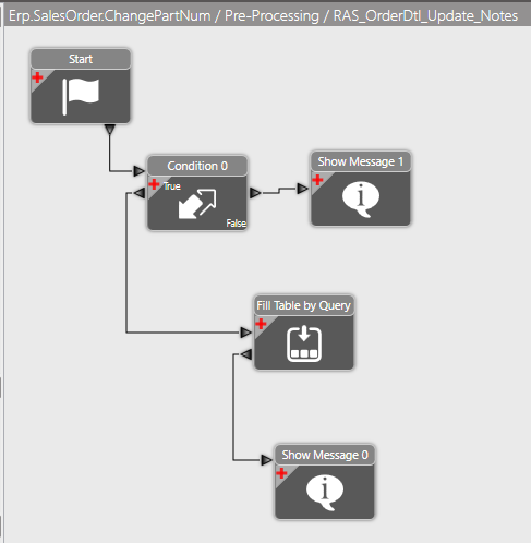

  1. Created a new UD field on ERP.PART_UD and regenerated database
  2. Added UD field to part entry comments tab
  3. Referenced one part and added a value for the new UD field
  4. Established ERP.ORDERDTL_UD has a field “Character03” I can reference for the data insert
  5. Created a pre-process method directive on ERP.SalesOrder
  6. Applied condition to method directive for added row in order detail table
  7. Utilized “Fill Table by Query” to associate ttOrderDtl to ERP.PART
  8. Added message notifications to see whether directive was passing/failing
With the directive enabled and creating a new order and associating a new line with the part that has the new UD field “CSNOTES_c” populated and hitting tab or clicking save. It seems the directive is not firing as I am not receiving notifications?
@Chris_Conn I did leave out the “Fill by Query” and utlized a notification for true/false and seems no output is displayed. Maybe I’m using the wrong method for this? Should I try the “ChangePartNumMaster” instead of “ChangePartNum”?

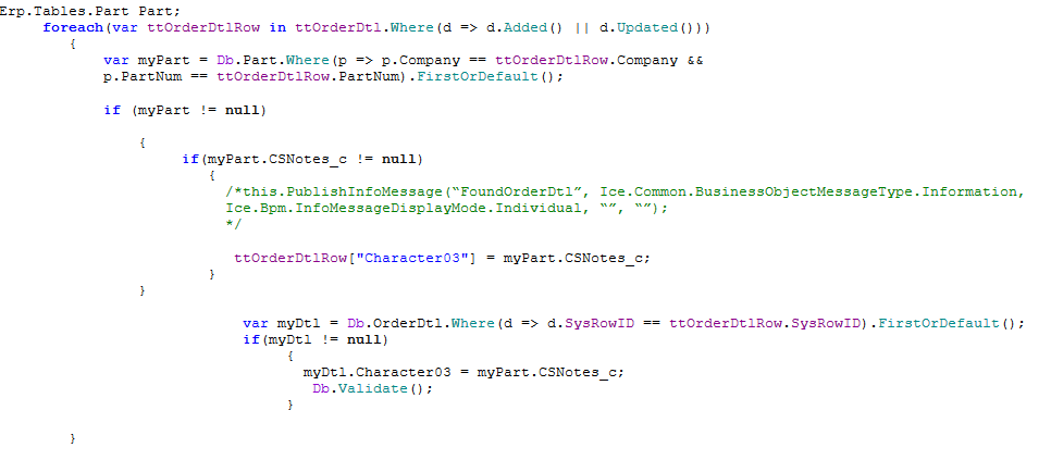

Just to make it more clear, I’d write it like this I think.
Erp.Tables.Part Part;
foreach(var ttOrderDtlRow in ttOrderDtl.Where(d => d.Added() || d.Updated()))
var Part = Db.Part.Where(p => p.Company == ttOrderDtlRow.Company &&
p.PartNum == ttOrderDtlRow.PartNum).FirstOrDefault();
if (Part != null)
  if(Part.CSNotes_c != null)
  /*this.PublishInfoMessage(“FoundOrderDtl”, Ice.Common.BusinessObjectMessageType.Information,
  Ice.Bpm.InfoMessageDisplayMode.Individual, “”, “”);
  ttOrderDtlRow[“Character03”] = Part.CSNotes_c;

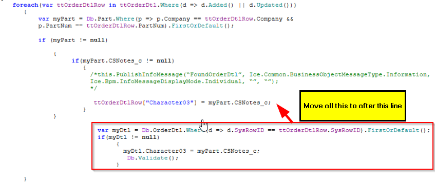

Also, since this method doesnt explictly save a record, you’ll need to:
Get and modify the base detail record
Call Db.Validate() after you mod the record to commit it
To get the proper record, something like this is probaby the quickest (just looking for the SysRow unique id):
var myDtl = Db.OrderDtl.Where(d => d.SysRowID == ttOrderDtlRow.SysRowID).FirstOrDefault();
if(myDtl != null)
  myDtl.Character03 = Part.CSNotes_c;
  Db.Validate();
As an afterthought, I wonder if the record actually already existing the DB at this point? I guess you’ll find out if this doesnt work lol. We can cross that bridge if we get to it.

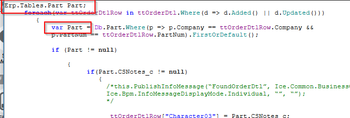

Each time I have been testing iv made sure its a new order with a new line based on the part with the note. Fixed the syntax error, had to rename “var Part” as “var myPart”
Ah yea I dont know why that top line is there. Remove it.
I thought you had to declare the ERP table prehand to using “DB”.table
Also, I’d move your var myDtl stuff within the brackets that check for data to be written (just below ttOrderDtlRow[“Character03”] = myPart.CSNotes_c)
Nope.
Part is defined as both a table and a table row…
Are you doing it as a post directive?
Charles
@Charles.Dingas pre process, did you go with post?
Post process…

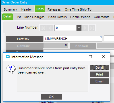

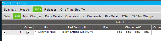

Switched it to post, got it working. Thanks a bunch!
