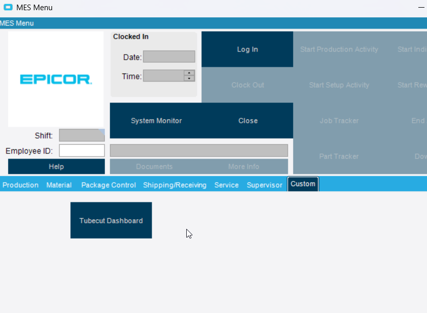

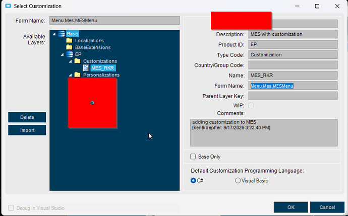

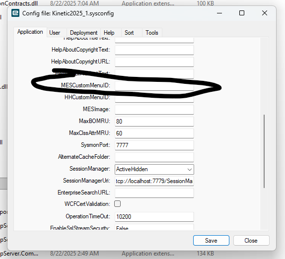

I am having some trouble deploying a customized MES. This is the first time I have tried something like this. I added a screen and then created a button to launch a dashboard. I have read through a few other posts and tried following the steps but I seem to get stuck at adding the custom menu item. I know I don’t have the correct program selected in the screenshot but the form name in the customization window is not available when I search in the programs. I believe this is the missing link to finish this up because then I just add this menuid to the sysconfig files. Any help would be greatly appreciated!

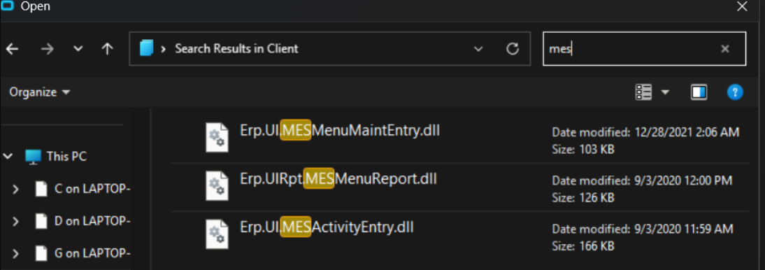

Did you try Erp.UI.MESActivityEntry.dll
don’t forget to update the config file so that folks use it.
found it
no i didn’t

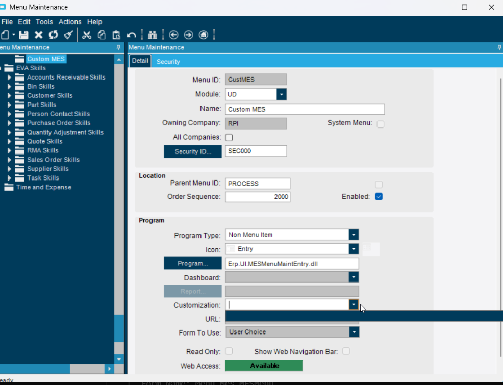

I tried that with my customization ID but I found out that is not correct. I don’t have a Menu Maintenance ID and I cannot figure out how to create one and apply the customization. The Program options in Menu Maintenance don’t apply to the MES Menu form.
