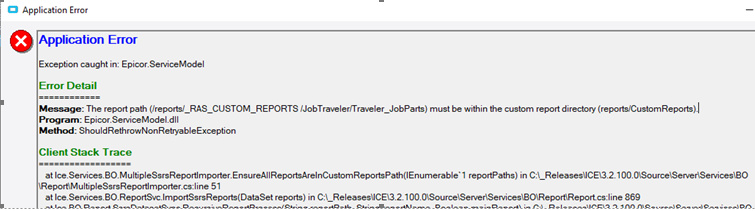

I noticed something new with the 10.2 that I would have thought would have been in previous versions. It seems now when copying a report style they restrict you to the default “Custom Reports” directory Epicor creates in the report instance. Which makes more sense from a support standpoint. (Since our other sites have custom canned reports scoured everywhere in separate folders its harder to manager/find the reports you need)
