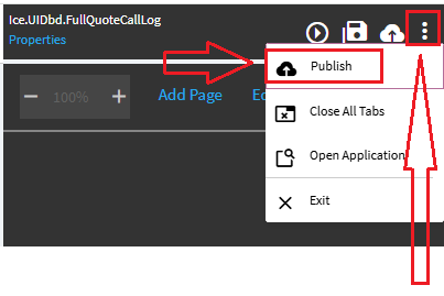

Hi Tammy,

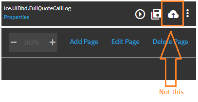

In application studio, make sure you have clicked on the overflow menu > Publish:
FYI: this commit button does nothing for us. Yet to find out what it does:

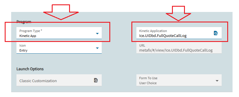

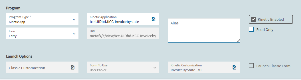

Once you have published the dashboard, go to menu maintenance and make sure you choose the Program Type as “Kinetic App”:

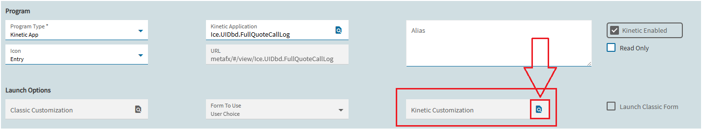

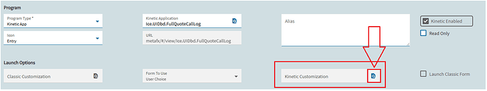

If you have layers, you can select them by clicking on the search icon here:
This performs a similar function one sees in source control like Git. It saves a version that one can restore to if needed, like a checkpoint in a game.

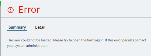

When I try to access it through the menu I get this error.
Just guessing, but did you also publish the Base layer of the dashboard?
yes. Do I need to remove that?
No, for the kinetic dashboards I’ve built, I published the Base layer, then published a child layer, and put the child layer in the Menu. I ran into errors when trying to put the Base layer in the Menu. I had to create a blank child layer to get rid of the loading error.
