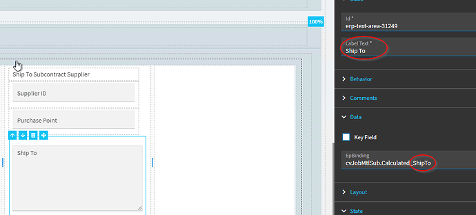

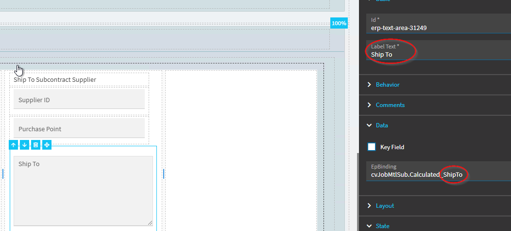

Is it just me? This is literally driving me insane. I set the label on my text box:

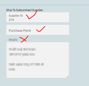

Then I preview:
What the heck Epicor???

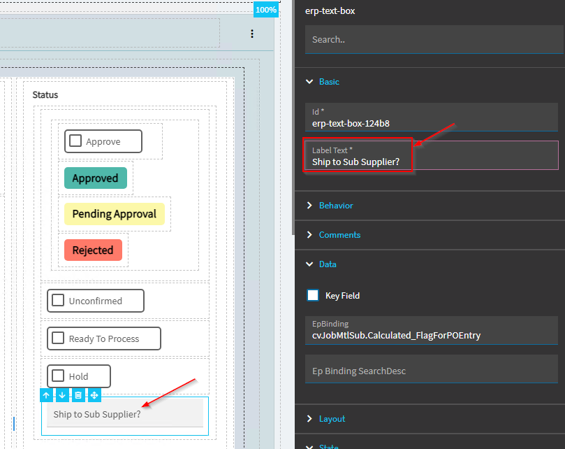

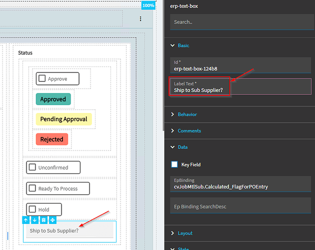

And its so inconsistent, here is it correctly labeling some fields and not others, all bound to the same custom view. WHY!!!

Yeah that is annoying but not the issue, the issue is the label is supposed to be Ship SPACE To not ShipTo
Oh damn, didn’t even notice that!
lol maybe my users won’t either. Its driving me crazy.
