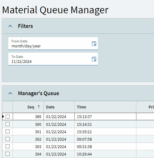

Is this app broke for anyone else on 2024.2.4? We cannot select records:
1
@timshuwy @Rich
I just tested and we’re in the same boat! Classic UI works but not Kinetic UI.
Seems like it only works when records are preloaded by selecting that option from the grid overflow.

Selecting the “load more records” …breaks all other grids in other apps…demo shortly after I enjoy the Friday

Just an FYI- this is still broken in 2024.2.6. THANK YOU to the person that found the workaround!!!
This is a known issue and is addressed by Epicor Development group as problem record PRB0290603.
It is fixed in version: 2024.2.9 per support
