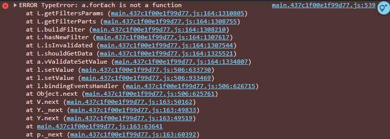

When I add the Filters Param setting to my combobox (ALL settings are just like the existing/working combo from Time Entry), I get an error in debugger and the combobox is disabled.
I see the following in Dev Tools:
This also happened in a previous effort to use a Job Assembly combobox, again, copying the settings exactly from an Epicor stock combobox. Adding the Filters Params resulted in the same forEach is not a function error.
I worked around that issue using a BAQ instead. But I am now seeing the same problem again and I just wanted to see if anybody else has seen/reported this.

That error strongly points to Filters Params being in the wrong shape/type.
a.forEach is not a function usually means Epicor expected an array/list of filter param objects, but it received a plain string/object instead.
getFiltersParams(a) expects a to be an array, because it immediately does: a.forEach(...)
But it is currently probably being stored as one plain string

Set a static param and see if it works.
Nope. Even a static value results in the forEach error.
