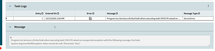

Yup tried a phantom pack and seen this error in the System Monitor:
Program Ice.Services.Lib.RunTask when executing task 3705172 raised an unexpected exception with the following message: RunTask:
System.ArgumentNullException: Value cannot be null. (Parameter ‘key’)
at System.Collections.Generic.Dictionary2.FindValue(TKey key) at System.Collections.Generic.Dictionary2.TryGetValue(TKey key, TValue& value)
at Ice.Core.RptTaskBase`1.XMLDumpTable(IRow row, String rptTableId) in C:_releases\ICE\ICE5.1.100.7\Source\Server\Internal\Lib\TaskLib\RptBase\RptTaskBase.cs:line 265
at Erp.Internal.SR.PackingSlipPrint.doShipHead() in C:_releases\ERP\ERP12.1.100.7\Source\Server\Internal\SR\PackingSlipPrint\PackingSlipPrint.cs:line 2305
at Erp.Internal.SR.PackingSlipPrint.RunProcess(Int64 Instance_TaskNum, String OutputFile) in C:_releases\ERP\ERP12.1.100.7\Source\Server\Internal\SR\PackingSlipPrint\PackingSlipPrint.cs:line 1088
at Ice.Hosting.TaskCaller.InnerExecuteTask(IceDataContext newContext) in C:_releases\ICE\ICE5.1.100.7\Source\Server\Framework\Epicor.Ice\Hosting\TaskCaller\TaskCaller.cs:line 71
at Ice.Hosting.TaskCaller.ExecuteTask() in C:_releases\ICE\ICE5.1.100.7\Source\Server\Framework\Epicor.Ice\Hosting\TaskCaller\TaskCaller.cs:line 62
at Ice.Lib.RunTask.BpmFriendlyTaskLauncher.Run(String sessionIdPrefix, IceContext db, Action taskRunner) in C:_releases\ICE\ICE5.1.100.0\Source\Server\Services\Lib\RunTask\BpmFriendlyTaskLauncher.cs:line 57
at Ice.Services.Lib.RunTaskSvc.InnerRunTask(Int64 ipTaskNum, Boolean suppressTransaction) in C:_releases\ICE\ICE5.1.100.0\Source\Server\Services\Lib\RunTask\RunTask.cs:line 349
