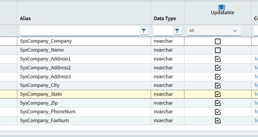

The BAQ needs to have several fields marked as Updatable but the grid itself cannot be updatable.

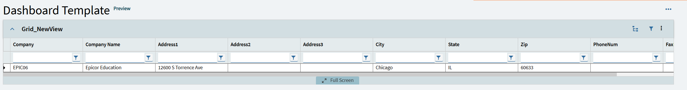

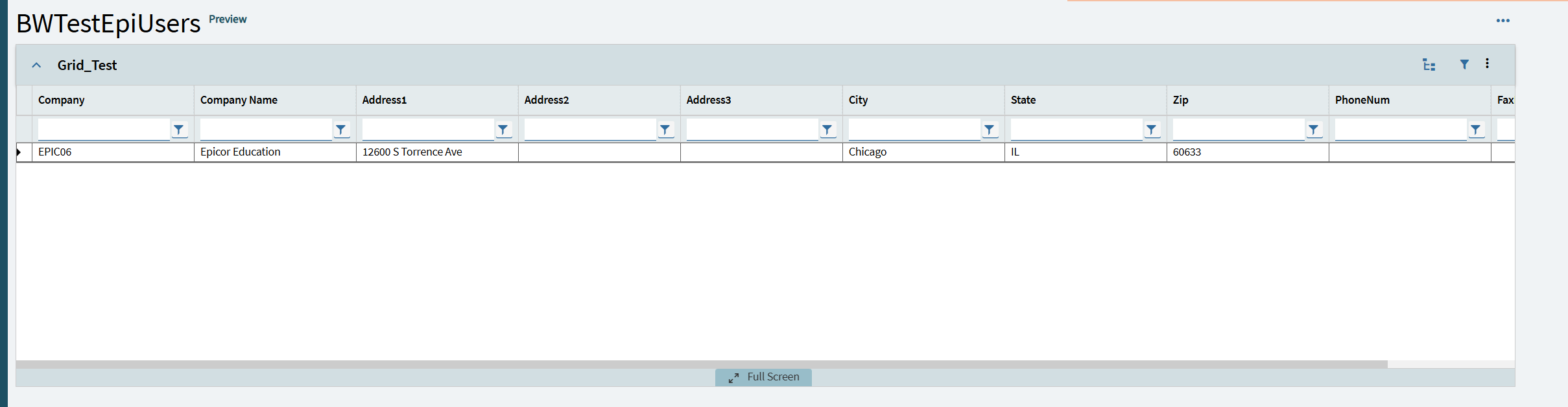

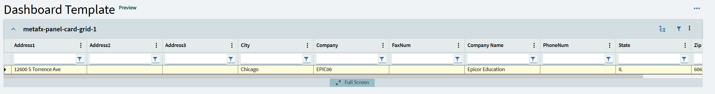

Tried in 2026.100.7 and i cannot replicate your behavior…
Tried Basic App Wizard marking as not allowed update and also went into the grid model and unticked editable.
Also tried a non wizard, manually creating the view, grid bound to the view and provider model set with server page which also worked. noticed that this made it editable even though Editable was not ticked so ticked and unticked it and is now not editable but still get all fields.
BAQ
New Manual App Columns not defined
New Manual App Columns defined
Wizard
Let me know if you think i have misunderstood. if not then looks like it is not broken in latest.
