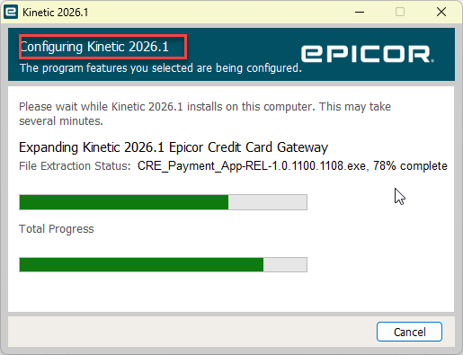

And a bit of installing later…
On an on-prem install the LocalClients folder still exists.

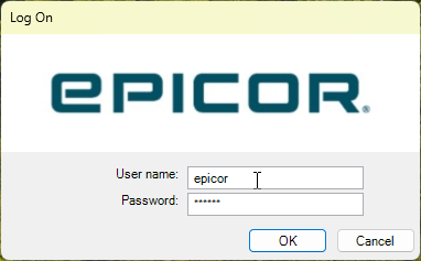

A shortcut does get installed. When you click on it you get.

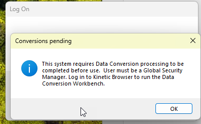

An if you have not run your conversion after you attempt to login you get.
Then after you run your conversions in the browser you can login again and you get

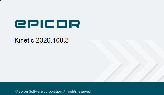

and a short while later you get… Drumroll please…
Surprise!

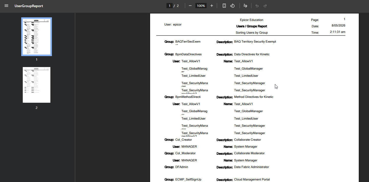

and the final test.
