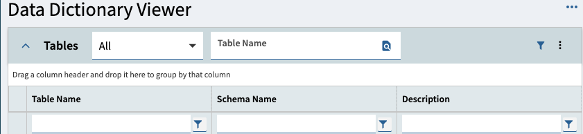

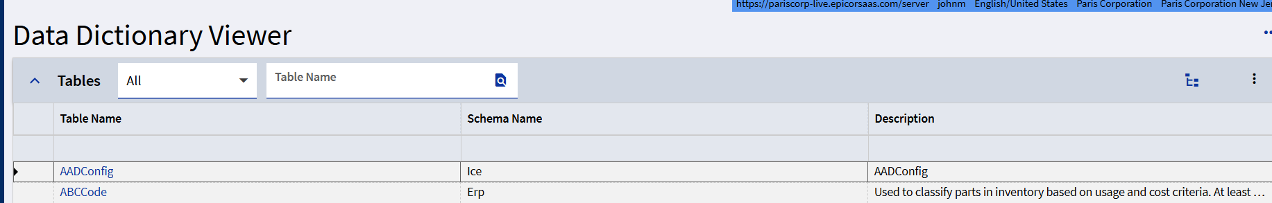

It’s not just you. Opened Data Dictionary Viewer, clicked the funnel to show the grid filters…no filters displayed and the icon disappeared.

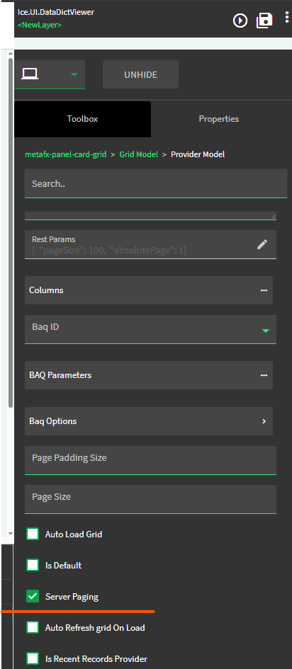

Does setting Sever Paging mode true fix the bug?
Try this in Data Dictionary in AppStudio then preview.

It didn’t for me. You can see the filter icon flash on screen then go away. So I can’t even pull up the filters.
Thanks for trying. Worth a shot. I’m shooting blind but you could also try marking at least one column filterable in the grid model.

Same here with Data Dictionary Viewer…clicked the funnel, no grid filters visible and the funnel disappeared. Oh happy day.

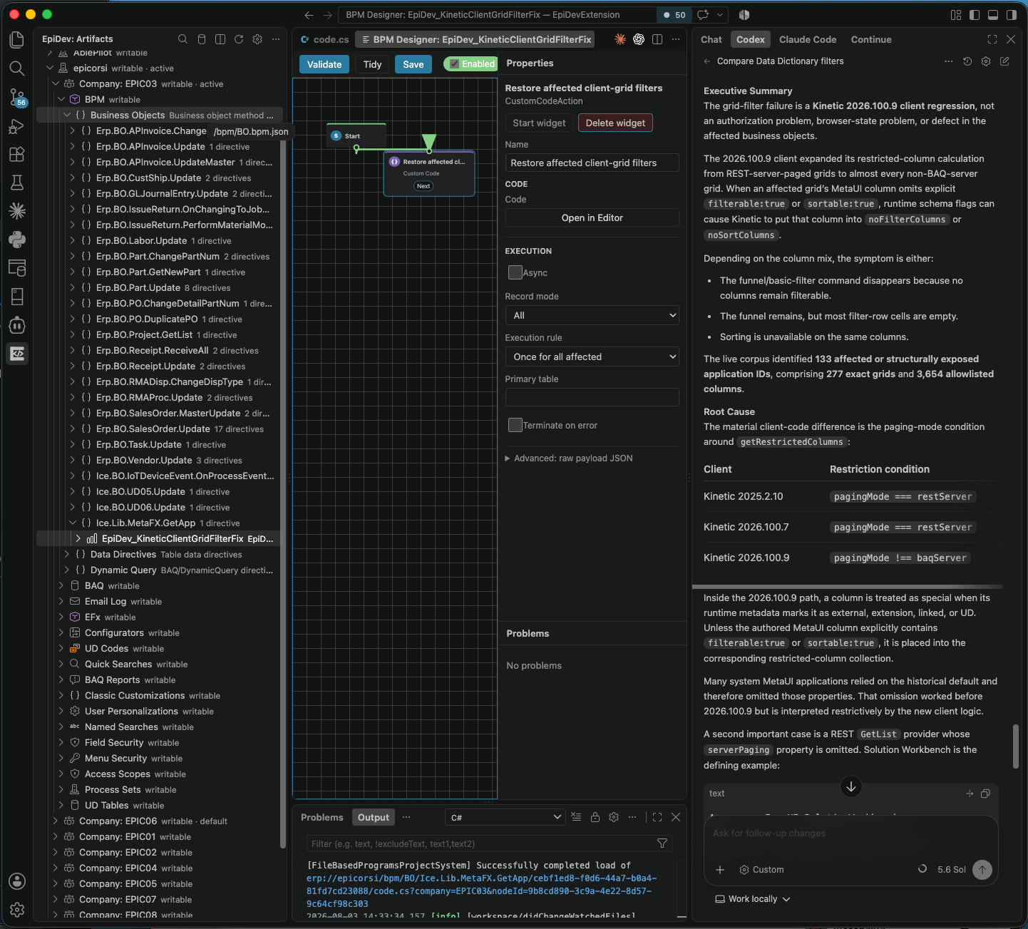

Hello,
I used EpiDev and ChatGPT 5.6 Sol High to generate the following root cause analysis, and associated BPM to patch the issue. Note that the BPM is against GetApp, so please know how to recover from a failed GetApp BPM if you try to use it. (you need to disable BPMs through sysconfig temporarily if on prem, or if SaaS you need a wide-open API key and knowledge of REST Help so that you can navigate to / query for the BPM and set it disabled)
EpiDev_KineticClientGridFilterFix.bpm (76.2 KB)
v2 BPM (Affects .8 and .9 only as those are the currently only known affected versions, but uses reflection to get the version, so is a bit of an epicor no-no - this version also fixes more columns because it addresses the grid settings vs. the column settings.)
EpiDev_KineticClientGridFilterFix.bpm (22.9 KB)
tldr; both work, v2 fixes more columns
Executive Summary
The grid-filter failure is a Kinetic 2026.100.9 client regression, not an authorization problem, browser-state problem, or defect in the affected business objects.
The 2026.100.9 client expanded its restricted-column calculation from REST-server-paged grids to almost every non-BAQ-server grid. When an affected grid’s MetaUI column omits explicit filterable:true or sortable:true, runtime schema flags can cause Kinetic to put that column into noFilterColumns or noSortColumns.
Depending on the column mix, the symptom is either:
  • The funnel/basic-filter command disappears because no columns remain filterable.
  • The funnel remains, but most filter-row cells are empty.
  • Sorting is unavailable on the same columns.
The live corpus identified 133 affected or structurally exposed application IDs, comprising 277 exact grids and 3,654 allowlisted columns.
Root Cause
The material client-code difference is the paging-mode condition around getRestrictedColumns:
Client Restriction condition
Kinetic 2025.2.10 pagingMode === restServer
Kinetic 2026.100.7 pagingMode === restServer
Kinetic 2026.100.9 pagingMode !== baqServer
Inside the 2026.100.9 path, a column is treated as special when its runtime metadata marks it as external, extension, linked, or UD. Unless the authored MetaUI column explicitly contains filterable:true or sortable:true, it is placed into the corresponding restricted-column collection.
Many system MetaUI applications relied on the historical default and therefore omitted those properties. That omission worked before 2026.100.9 but is interpreted restrictively by the new client logic.
A second important case is a REST GetList provider whose serverPaging property is omitted. Solution Workbench is the defining example:
App:      Ice.UI.SolutionWorkbench
Grid:     grdLandingPage
Provider: Ice.BO.ExportPackageSvc.GetList
Paging:   serverPaging omitted

BPM Fix
The deployed fix is a post-processing method directive:
Method:       BO/Ice.Lib.MetaFX.GetApp
Directive ID: cebf1ed8-f0d6-44a7-b0a4-81fd7cd23088
Group:        EpiDevCompatibility
Order:        10
Enabled:      true
The BPM operates on the generated GetApp response and is bounded at three levels:
  1. The requested application ID must match one of the 133 exact app IDs.
  2. A descendant grid must match an exact app/grid specification.
  3. A column must match an exact allowlisted field for that grid.
For a matching column, the BPM performs only these null/default repairs:
if (column["filterable"] == null)
    column["filterable"] = true;
if (column["sortable"] == null)
    column["sortable"] = true;
It deliberately does not replace explicit values. For example, AP Invoice Entry’s authored VendorNumName remains filterable:false and sortable:false.
Fail-Open Design
The final BPM has two independent exception boundaries:
  • Request identification is guarded. If it fails, requestId remains null and no repair logic runs.
  • Catalog parsing, JSON conversion, traversal, and mutation are guarded separately.
The BPM creates a JSON clone of the original GetApp result, makes every change against the clone, and assigns the clone to result only after the entire pass succeeds. If any processing operation throws, the catch block performs no action and the original unmodified response continues through the pipeline. This prevents both a propagated GetApp exception and a partially modified response.
BPM Code:

if (!string.IsNullOrEmpty(requestId) &&
    result != null &&
    supportedApps.IndexOf("|" + requestId + "|", StringComparison.OrdinalIgnoreCase) >= 0)
    try
        var appFixes = fixCatalog
            .Split(new[] { '\r', '\n' }, StringSplitOptions.RemoveEmptyEntries)
            .Select(line => line.Split('|'))
            .Where(parts =>
                parts.Length == 3 &&
                string.Equals(parts[0], requestId, StringComparison.OrdinalIgnoreCase))
            .ToArray();
        var sourceApp = result as Newtonsoft.Json.Linq.JObject ??
            Newtonsoft.Json.Linq.JObject.FromObject(result);
        var app = Newtonsoft.Json.Linq.JObject.Parse(
            sourceApp.ToString(Newtonsoft.Json.Formatting.None));
        var updated = false;
        foreach (var grid in app.Descendants().OfType<Newtonsoft.Json.Linq.JObject>())
            var gridId = Convert.ToString(grid["id"]);
            var columns = grid["columns"] as Newtonsoft.Json.Linq.JArray;
            if (columns == null || string.IsNullOrEmpty(gridId))
                continue;
            var gridFix = appFixes.FirstOrDefault(parts =>
                string.Equals(parts[1], gridId, StringComparison.Ordinal));
            if (gridFix == null)
                continue;
            var allowedFields = gridFix[2].Split(',');
            foreach (var columnToken in columns)
                var column = columnToken as Newtonsoft.Json.Linq.JObject;
                var field = Convert.ToString(column?["field"]);
                if (!allowedFields.Any(allowedField =>
                    string.Equals(allowedField, field, StringComparison.Ordinal)))
                    continue;
                var filterable = column["filterable"];
                if (filterable == null ||
                    filterable.Type == Newtonsoft.Json.Linq.JTokenType.Null)
                    updated = true;
                var sortable = column["sortable"];
                if (sortable == null ||
                    sortable.Type == Newtonsoft.Json.Linq.JTokenType.Null)
                    updated = true;
        if (updated)
            result = app;
    catch (Exception)
        // Fail open: keep the original GetApp result unchanged.
v2 BPM Code:
string requestId = null;
try
    if (request != null)
        var requestIdProperty = request.GetType()
            .GetProperties()
            .FirstOrDefault(property => string.Equals(
                property.Name,
                "id",
                StringComparison.OrdinalIgnoreCase));
        if (requestIdProperty != null)
            requestId = Convert.ToString(
                requestIdProperty.GetValue(request, null));
catch (Exception)
    requestId = null;
bool affectedProductVersion = false;
try
    var versioningType = System.Type.GetType(
        "Ice.VersioningApp, Epicor.App.Version",
        false);
    var getProductVersion = versioningType?.GetMethod(
        "GetProductVersion",
        System.Reflection.BindingFlags.Public |
            System.Reflection.BindingFlags.Static);
    var productVersion = getProductVersion?.Invoke(
        null,
        null) as Version;
        productVersion != null &&
        productVersion.Major == 2026 &&
        productVersion.Minor == 100 &&
        (productVersion.Build == 8 ||
            productVersion.Build == 9);
catch (Exception)
const string affectedApps = @"|Erp.UI.AGCAEAInvoiceTracker|Erp.UI.APBillOfExchangeEntry|Erp.UI.APCheckTracker|Erp.UI.APInvoiceEntry|Erp.UI.APInvoiceTracker|Erp.UI.APLOCTracker|Erp.UI.APPInstrumentEntry|Erp.UI.APPInstrumentTracker|Erp.UI.ARBOEStatusChgEntry|Erp.UI.ARBillOfExchangeEntry|Erp.UI.ARInvoiceEntry|Erp.UI.ARInvoiceTracker|Erp.UI.ARLOCTracker|Erp.UI.ARPIBatchGen|Erp.UI.ARPIWriteOffEntry|Erp.UI.ARPInstrumentEntry|Erp.UI.ARPInstrumentTracker|Erp.UI.ARPromissoryNoteEntry|Erp.UI.ARRecTracker|Erp.UI.ATPEntry|Erp.UI.AlcHistTracker|Erp.UI.AssetTracker|Erp.UI.AutomatedFulfillmentRuleEntry|Erp.UI.BankAcctEntry|Erp.UI.BankFileImportExpressEntry|Erp.UI.BankFileImportWorkbenchEntry|Erp.UI.BankTranCodeEntry|Erp.UI.BuyerWorkbenchEntry|Erp.UI.CNCustomsHandbookEntry|Erp.UI.CRMCallEntry|Erp.UI.CashRecEntry|Erp.UI.CashRecTracker|Erp.UI.CashReceiptAdjustmentEntry|Erp.UI.ChartTracker|Erp.UI.ConsMonitorEntry|Erp.UI.ContactTracker|Erp.UI.CreditManagerEntry|Erp.UI.CurrExRateEntry|Erp.UI.CurrencyEntry|Erp.UI.CustShipEntry|Erp.UI.CustShipSummary|Erp.UI.CustomerEntry|Erp.UI.CustomerPartXRefEntry|Erp.UI.CycleCountTracker|Erp.UI.DEPartFIFOTranHistTracker|Erp.UI.DataHealthCheckEntry|Erp.UI.DemandEntry|Erp.UI.DmdWorkBench|Erp.UI.ElecIntEntry|Erp.UI.EmpCourseEntry|Erp.UI.GLAccountEntry|Erp.UI.GLJournalEntry|Erp.UI.GLTransactionMatching|Erp.UI.IncomingICPOSugEntry|Erp.UI.JobAdjustmentEntry|Erp.UI.JobClosingEntry|Erp.UI.JobEntry|Erp.UI.JournalTracker|Erp.UI.LbrPrjRoleEntry|Erp.UI.LegalNumberEntry|Erp.UI.LocationOwnershipTFEntry|Erp.UI.LocationOwnershipTracker|Erp.UI.LotTracker|Erp.UI.MaterialQueueEntry|Erp.UI.MaterialQueueMgrEntry|Erp.UI.MoveWIPPCIDEntry|Erp.UI.MoveWIPPCIDRequestEntry|Erp.UI.NonFinBalDirectEntry|Erp.UI.PCashDeskEntry|Erp.UI.PIStatusChgEntry|Erp.UI.POEntry|Erp.UI.PartAdvisor|Erp.UI.PartEntry|Erp.UI.PartXRefMfgEntry|Erp.UI.PaymentEntryEntry|Erp.UI.PayrollCheckEntry|Erp.UI.PayrollCheckTracker|Erp.UI.PcLookupTblEntry|Erp.UI.PeLogViewer|Erp.UI.PipeLineEntry|Erp.UI.PkgControlIDEntry|Erp.UI.PkgControlIDTracker|Erp.UI.PkgControlVoidPCIDLabelEntry|Erp.UI.PlanContractEntry|Erp.UI.ProjectEntry|Erp.UI.PurchaseAdvisorEntry|Erp.UI.QuickEntry|Erp.UI.QuoteEntry|Erp.UI.RMATracker|Erp.UI.ReceiptEntry|Erp.UI.RecipeEntry|Erp.UI.SalesOrderEntry|Erp.UI.SalesPersonWorkBenchTracker|Erp.UI.SalesTerEntry|Erp.UI.SerialNumberMaint|Erp.UI.SerialNumberTracker|Erp.UI.ServiceContractEntry|Erp.UI.ShopTracker|Erp.UI.SpecificationEntry|Erp.UI.StageShipConfirmEntry|Erp.UI.SupplierPriceListEntry|Erp.UI.TWVoidAndBlankGUINums|Erp.UI.TagCountEntry|Erp.UI.TaskListEntry|Erp.UI.TimeExpApprovalEntry|Erp.UI.TransOrderReceipt|Erp.UI.TransactionLogEntry|Erp.UI.TransferOrderEntry|Erp.UI.USTINValidationResult|Erp.UI.VoidPRCheckEntry|Erp.UI.VoidPackEntry|Ice.UI.AttachmentTransferEntry|Ice.UI.CollaborateSecurityEntry|Ice.UI.ConnectedUsers|Ice.UI.ContextMenuEntry|Ice.UI.DataDictViewer|Ice.UI.DataFabricFieldMapMaintenance|Ice.UI.DataFabricFunctionMaintenance|Ice.UI.DigitalCertificateStoreEntry|Ice.UI.ESIndexMaintenance|Ice.UI.ExtCompanyEntry|Ice.UI.IoTConfigEntry|Ice.UI.LangTranEntry|Ice.UI.MenuMEntry|Ice.UI.MenuSecurityEntry|Ice.UI.ObjectSecurityEntry|Ice.UI.ProcessSetEntry|Ice.UI.SecColumnEntry|Ice.UI.SessionMaint|Ice.UI.SolutionTypeEntry|Ice.UI.SolutionWorkbench|Ice.UI.UDMapEntry|Ice.UI.UDTable|";
if (affectedProductVersion &&
    affectedApps.IndexOf(
        StringComparison.OrdinalIgnoreCase) >= 0 &&
    result != null)
    try
            .Where(candidate =>
                candidate["columns"] is Newtonsoft.Json.Linq.JArray))
            var columns =
            var providerModels =
                new System.Collections.Generic.List<
                    Newtonsoft.Json.Linq.JObject>();
            var directProvider =
                grid["providerModel"] as Newtonsoft.Json.Linq.JObject;
            if (directProvider != null)
                providerModels.Add(directProvider);
            var componentModel =
                grid.Parent?.Parent as Newtonsoft.Json.Linq.JObject;
            var viewOptions =
                componentModel?["viewOptions"] as Newtonsoft.Json.Linq.JArray;
            if (viewOptions != null)
                providerModels.AddRange(
                    viewOptions.Children<
                        Newtonsoft.Json.Linq.JObject>());
            var restProviders = providerModels
                .Where(provider =>
                    provider["svc"] != null &&
                    provider["baqId"] == null)
                .Distinct()
                .ToArray();
            foreach (var provider in restProviders)
                var serverPaging = provider["serverPaging"];
                if (serverPaging == null ||
                    serverPaging.Type ==
                    provider["serverPaging"] = false;
                    updated = true;
        if (updated)
            result = app;
    catch (Exception)

I marked @GabeFranco as the solution but I am unable to validate as at this time I don’t have the bandwidth to resolve an issue if something comes up with the GetApp BAQ.
