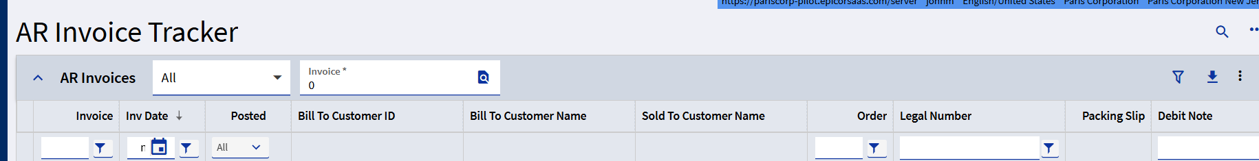

Woof…my apologies as I missed the list. Just spotchecked one at random - AR Invoice Tracker and do see some inaccessible fields - ones that would be extremely useful if one needed to search by name.
So…yeah. This stinks.
So what your screenshot shows is completely normal and existed before this change too. What has changed now is that even after clicking the arrow to toggle off progressive load, you still cannot search or filter on those fields.
