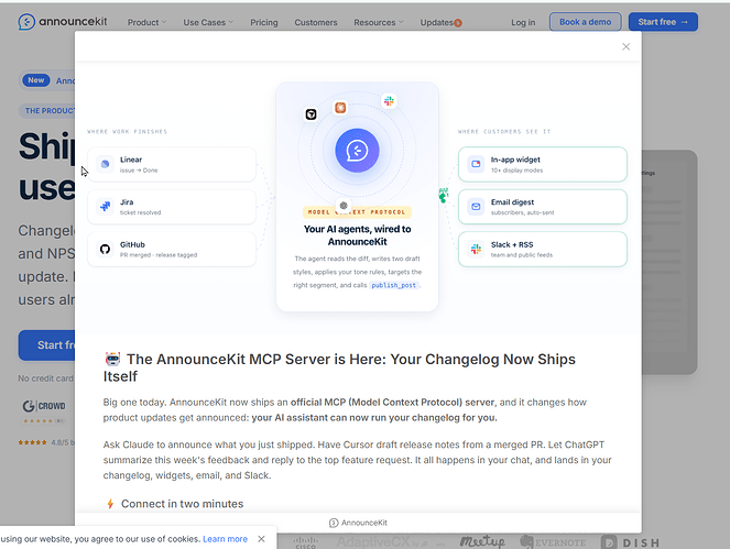

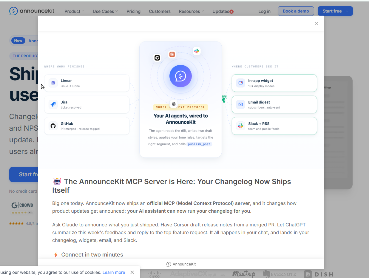

The new announcement thingy is really impressive :roll_eyes:
And the info link takes me to . . .a third party product site??

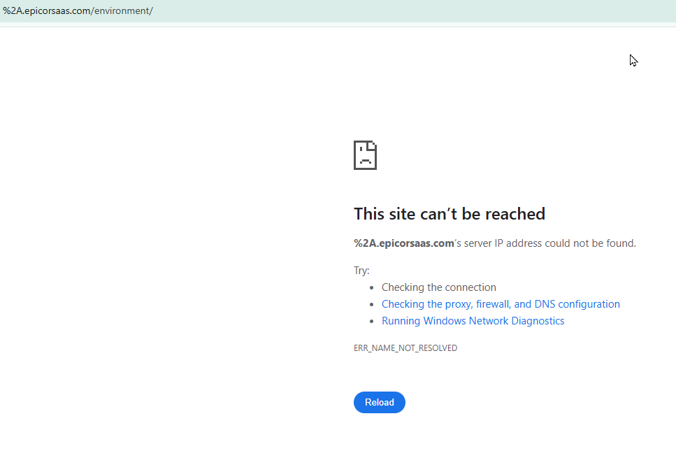

If I click on the announcement itself and then click on the home page I get:
I guess this got about as much QA as any other new feature epicor puts out.
