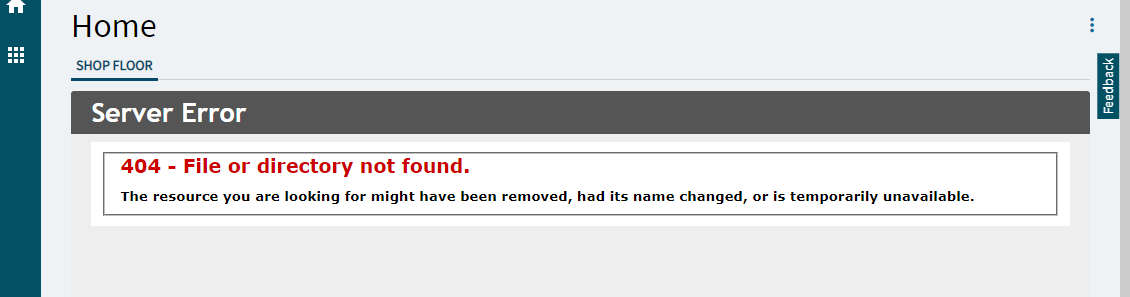

Hello,
I’m messing around with the Kinetic MES and when the application opens to a 404 error right away. Any ideas what is missing, blocked, or wrong? This is 2022.1.9.
Hello,
same problem here, did you ever get a resolution?
I think it’s just deprecated in 2021+.
“Data Collection” is the new version - that’s the actual functioning Kinetic-based MES.
You should have shortcuts in your Start Menu for DC.
In the browser, I think it’s something like this:
https://YourServer.com/ProductionOrOtherInstanceName/Apps/ERP/Home/#/login?mode=dc
bummer DC isn’t as nice looking and Kinetic MES.
