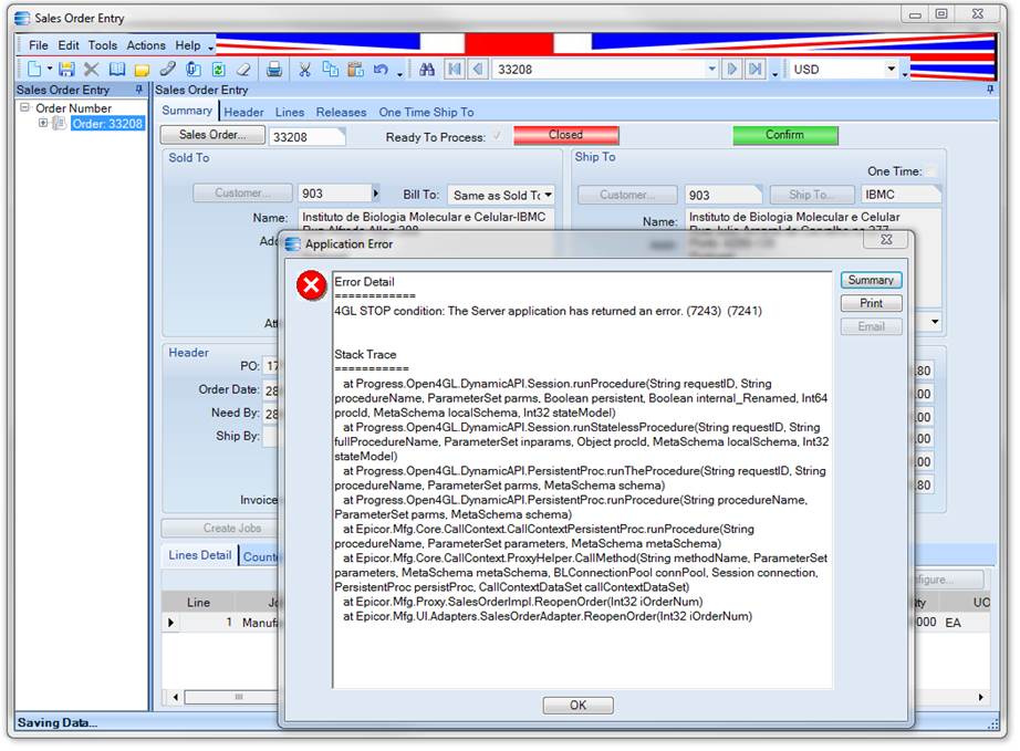

4GL error
EPICOR 9.05.701
We keep getting this error and not sure how to fix it…
