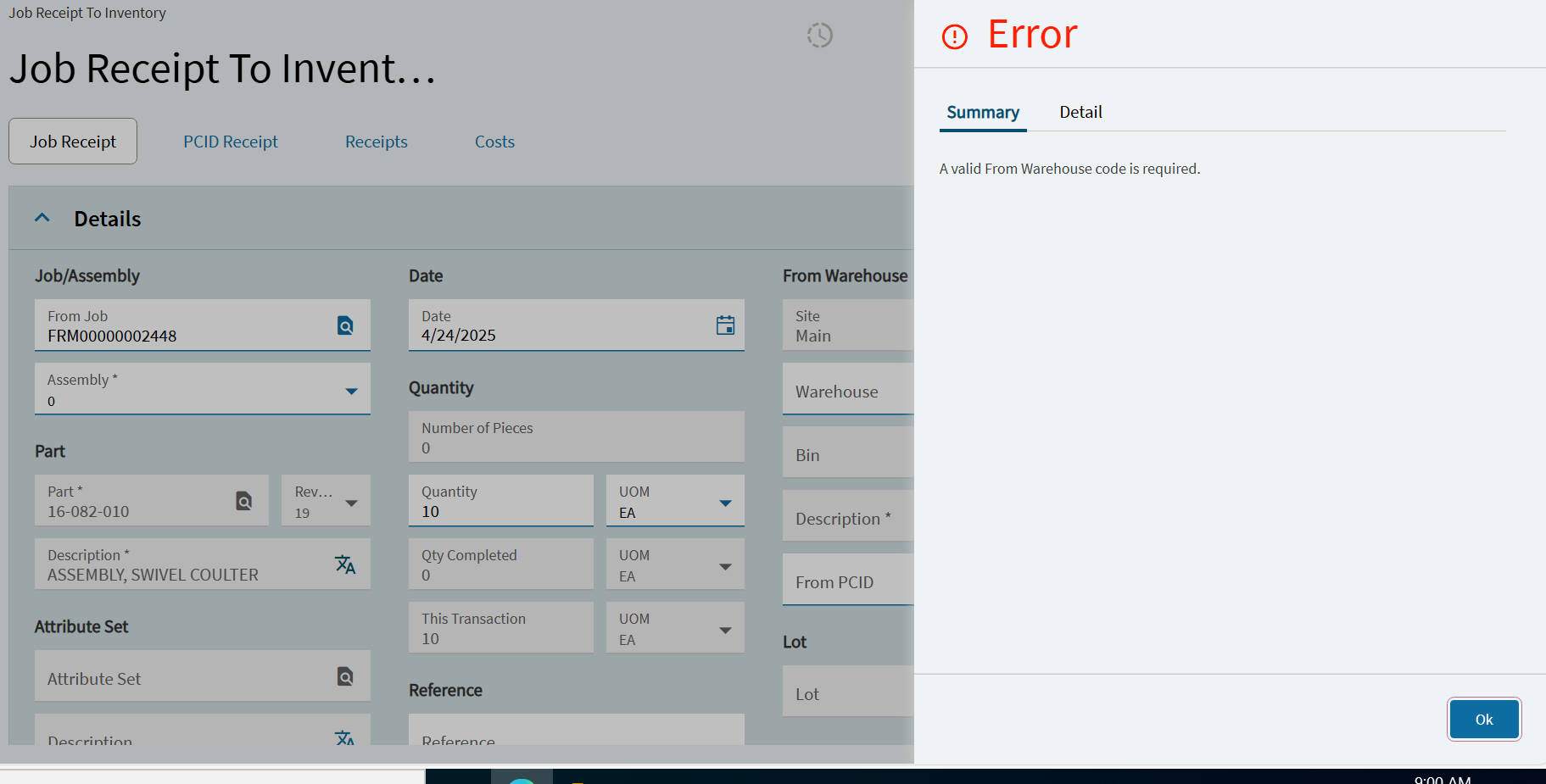

A valid from warehouse code required

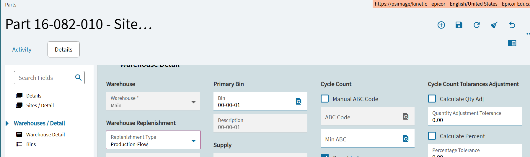

"I have configured the primary warehouse and bin in Part Maintenance, but I am encountering an error when performing the job receipt to inventory.
From warehouse and bin are blank.
AND part 16-082-010 might not be associated with any site/warehouses.
it associated site and warehouse.

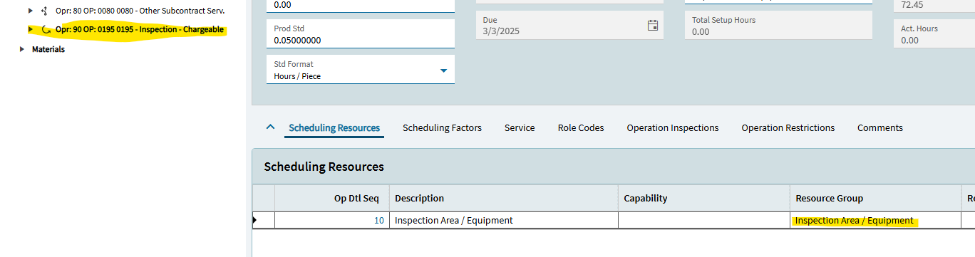

When you’re receiving from a job…

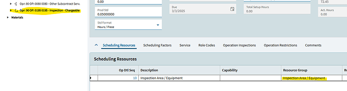

The From Warehouse/Bin should be tied to whatever “Resource” the operation is tied to on the job.
Operation on the job… last Op is for Inspection:

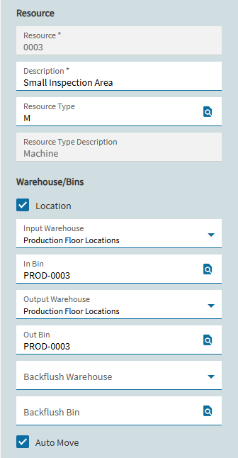

Here’s the Warehouse/Bin assigned to that Resource:

umm… not sure how that works then. Each operation has a scheduled resource tied to it. Each resource has a Warehouse/Bin tied to it. When you issue material TO a job, you’re issuing it to a resource.
When you Receive the finished product FROM a job, you’re receiving it FROM a resource.

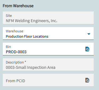

I would just add a dummy operation so there is something to bounce the qty in and out of.
Are you able to issue material to the job?
yes David, I added the dummy operation, and I can see the warehouse and bin now.
