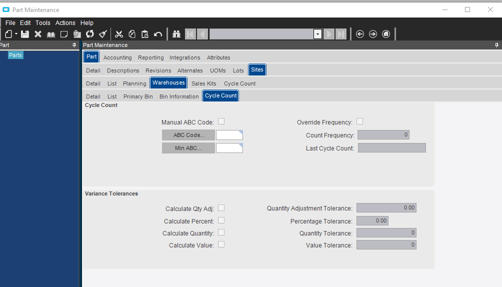

jeowings
(Josh Owings)
October 7, 2019, 5:13pm
6
It is in the Part Maintenance screen, but I recommend doing it using the DMT tool if you have a bunch to change.
See this screen print for the tab with the checkbox.
