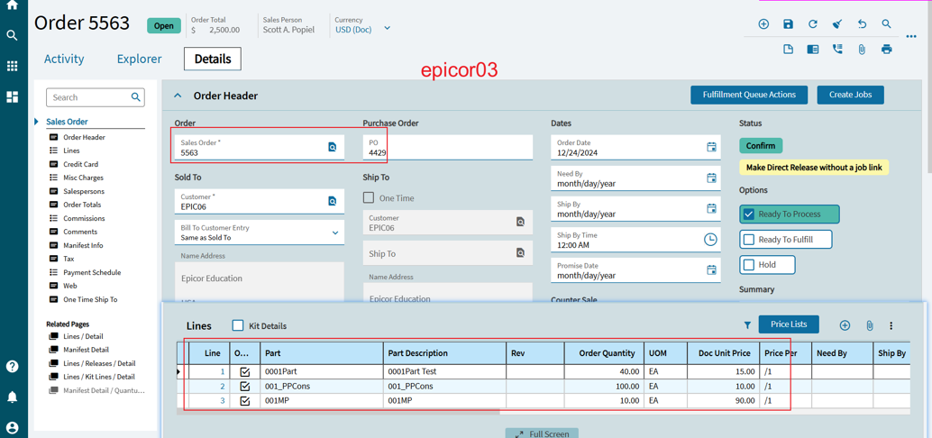

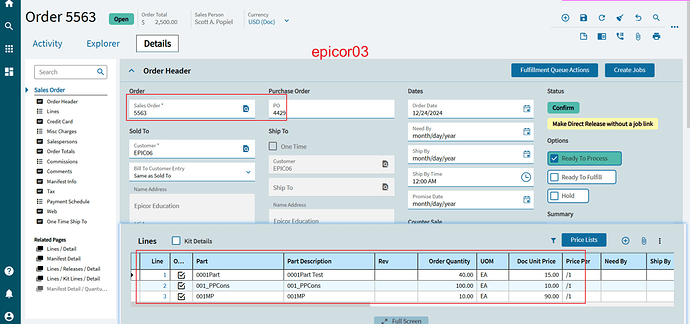

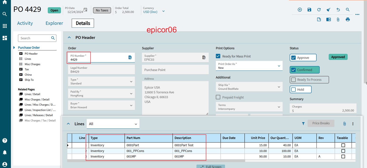

I follow the information and I create the PO and then try to create SO that link with the PO.
After I click ready for order, it show ‘Customer EPIC06 Ship To for PO 4550 is invalid’.
How can I make it valid?
Hi
The PO Line needs to be Buy to Other for the SO information to be linked, but I would suggest that you flag the Order Release as Buy to Order, then when you run PO suggestions the PO will automatically be linked to the order rather than the user having to manually create the PO and then link the Order
