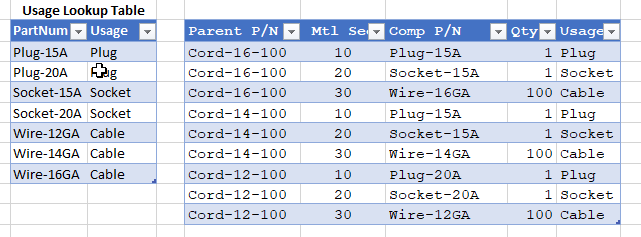

Raw data from E10, listing Materials for all variants of the part to be made as a configuration:
After assigning a “usage” (which I did with a lookup table) to get:

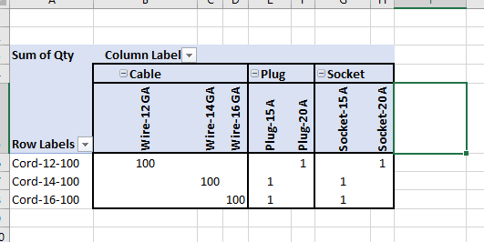

Then a pivot table to show a Matrix of which parts are used in which final P/N
Pivot table details:
While your engineers probably know off the top of their head, what goes into each variant, doing the above will show you what all you need for the template.
