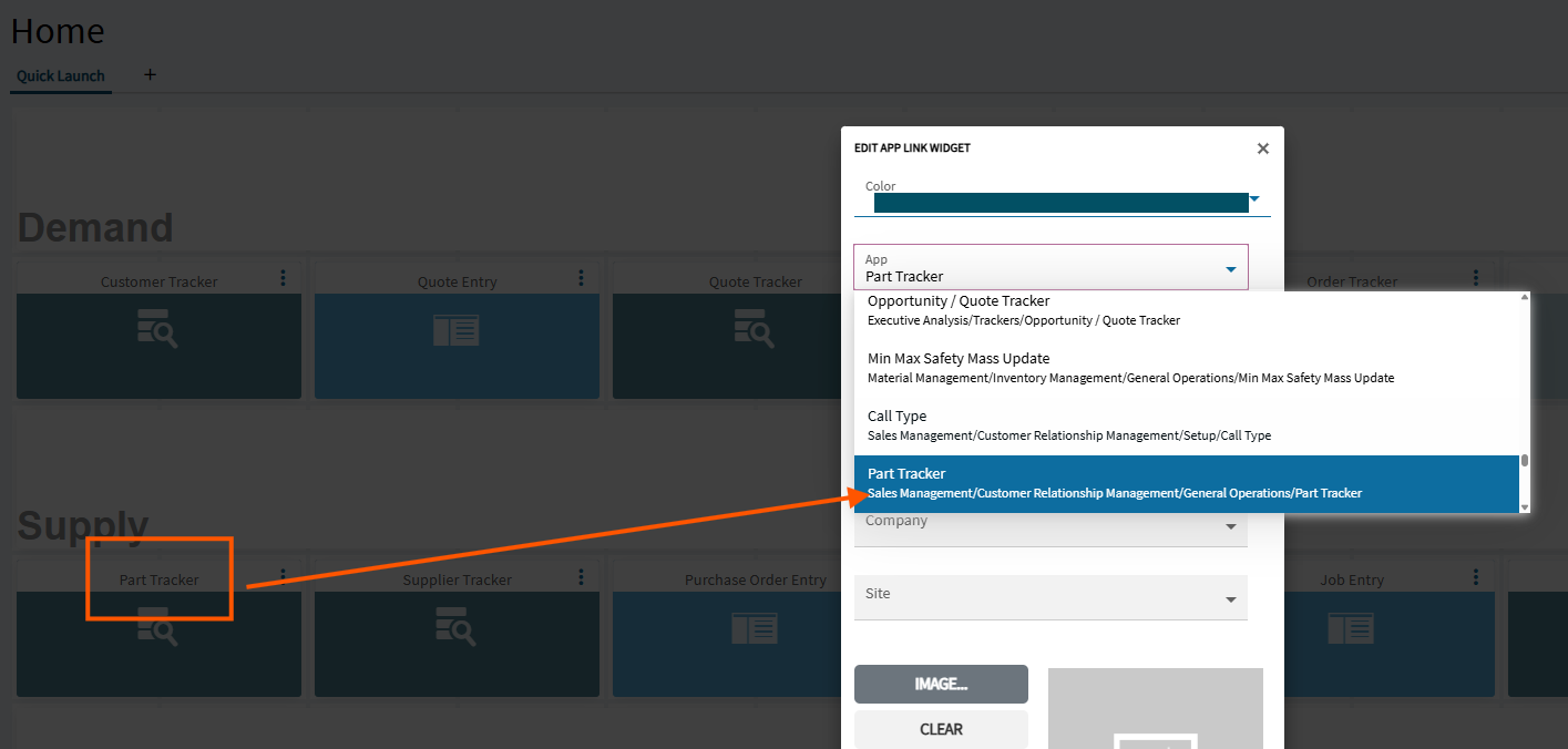

Each “widget” on the quick launch screen is set to a particular menu PATH.
For example… the Part Tracker widget in the below image is tied to the following menu path:
Sales Management > Customer Relationship Management > General Operations > Part Tracker
That means, even though there are a dozen other Part Tracker menus in the system… only people who have access to Sales Management, CRM, General Operations menu folder can use that widget.

You have to edit the homepage (I think you actually create a new one IIRC) and then on each of those tiles select Edit and repoint them to a menu item the particular user has access to.
Security applies in such a way that just because they have Part Tracker from the Production Management > Job Management > General they do not necessarily have it through Sales > Order > General, if any point in structure chain is not available to them (They have access to Sales Management but NOT to Order Management then no amount of allow on anything that lives under OM will give them access to it.) they will not be able to open the screen.
From there you publish the layout and if you want you can go into the individual users setup page and assign them a default layout (your new layout you just published).

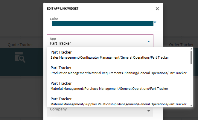

Just wanted to provide an image to build on what @leonardpothier stated… Part Tracker is a good example because there are many.
See in the image below that if you create a widget for Part Tracker, you have to select a Part Tracker with a menu path to which that specific user has access.

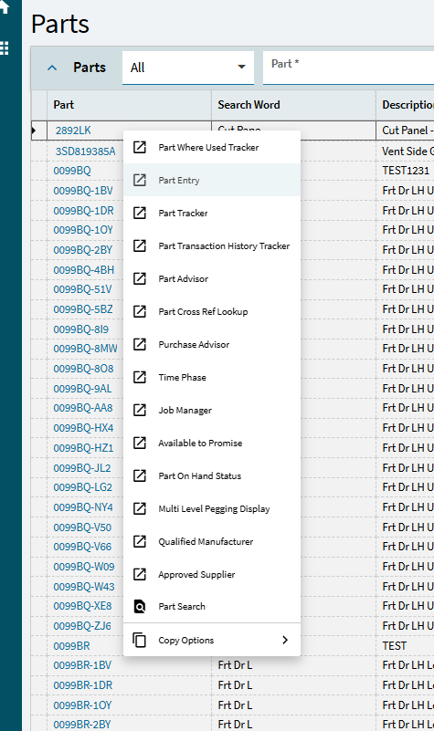

Hi I’ve now found an issue
How do i stop users from being able to use the Part Entry on the left mouse click, I don’t know what Part Entry screen its going to. But I thought I had disabled that screen.

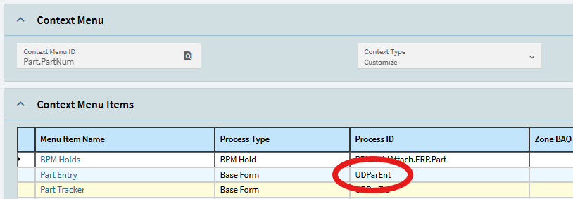

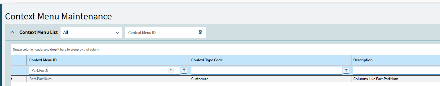

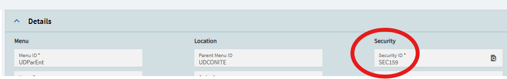

You need to find the menu that the Context Menu is using, look in Context Menu Maintenance, in this case you are likely looking for Part.PartNum Context ID. Inside that record will be a list of menu items that can be called when you right click on a part number. Find the entry for Part Entry and the Process ID will correspond to the Menu ID that it is actually calling. From there you go to Menu Maintenance and find what Security ID is tied to that screen (or the folder structure) and then go to Menu Security Maintenance on that Security ID and make changes to it.
As noted above, some screens appear in many places and each of those could have their own security so you have to go through them all to ensure you have blocked/allowed what you want.

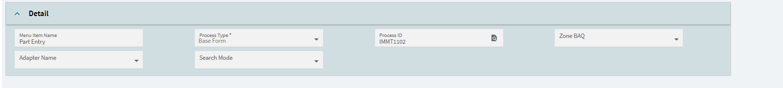

When I (please see below) Im making reference of that number IMMT1102
But when how to i link that back to menu maintenance.

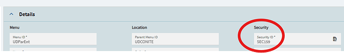

In Menu Maintenance if you select All it will let you search and you can enter the Menu ID and it will bring up that one that you can go into and see the values for Security ID.
Alternatively you can dig through the Main Menu category, that looks like it would live in the Material Management > Inventory Management > Setup area.
