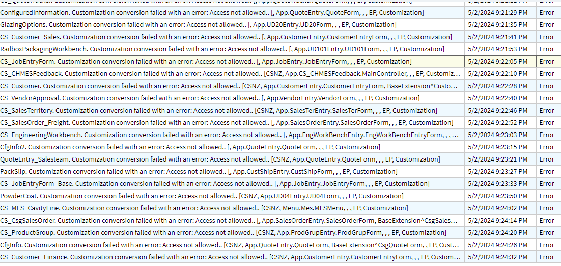

Hi there,
I am upgrading Epicor 10.2.7 to 2023.2 and when Running a conversion in Conversion WB to Create Kinetic Customisations all my exsiting cusomisations are getting an error - Access Not Allowed.
I am logging in as manager so dont think security is an issue. Anyone has any ideas?
I hate to be the bearer of bad news, but anything other than minor cosmetic customizations will not translate to Kinetic customizations. All of that will have to be done manually.
That being said, why you are getting these specific errors, I can’t speak to.
