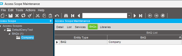

Ok this correlates with that I was thinking. I set up an access scope with no permissions attached. Then, I added this scope to the integration user. I try to hit the BAQ svc endpoint with a simple query that does not have anything else interesting about it (no Security ID, for instance) from Postman
Keep in mind the test below is with v1 API (credentials only) but I’ll demo both ways and show they work as described.
(my snipping tool is acting up, otherwise I’d have cleaner screenshots)
400 Forbidden
If I add the BAQ to the Access Scope, it now allows me:
200 OK

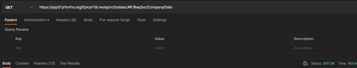

Test 2 is v2 (API Key + Credentials)
Kept the BAQ permissions on the scope and now accessing API with key + creds:
Then removed the BAQ from the scope:
