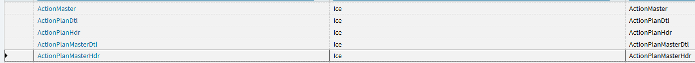

Just gonna keep documenting my progress here. It looks like there are 5 tables related to Action Plans but the current menu items only interact with 3 of them.
ActionPlanMasterHdr and ActionPlanMasterDtl don’t get anything written to them when an action plan is created and the ActionPlanHdr table has a field called ActionPlanInstance that makes me think if there were records on ActionPlanMasterHdr, it would increment the count in that field.
Maybe tomorrow I’ll try creating a record in ActionPlanMasterHdr through Rest and see if it becomes a selectable plan on the Action Plan screen.
