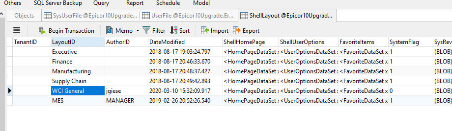

So the layouts themselves appear to be stored in Ice.ShellLayout. It includes Homepage layout, User options and favorites. I knew it includes favorites but didn’t know it included user options.

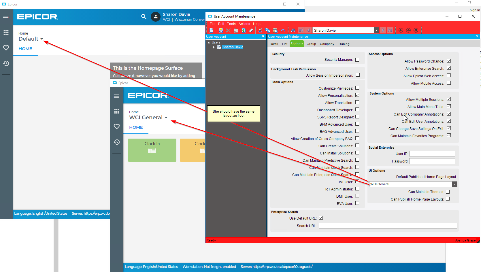

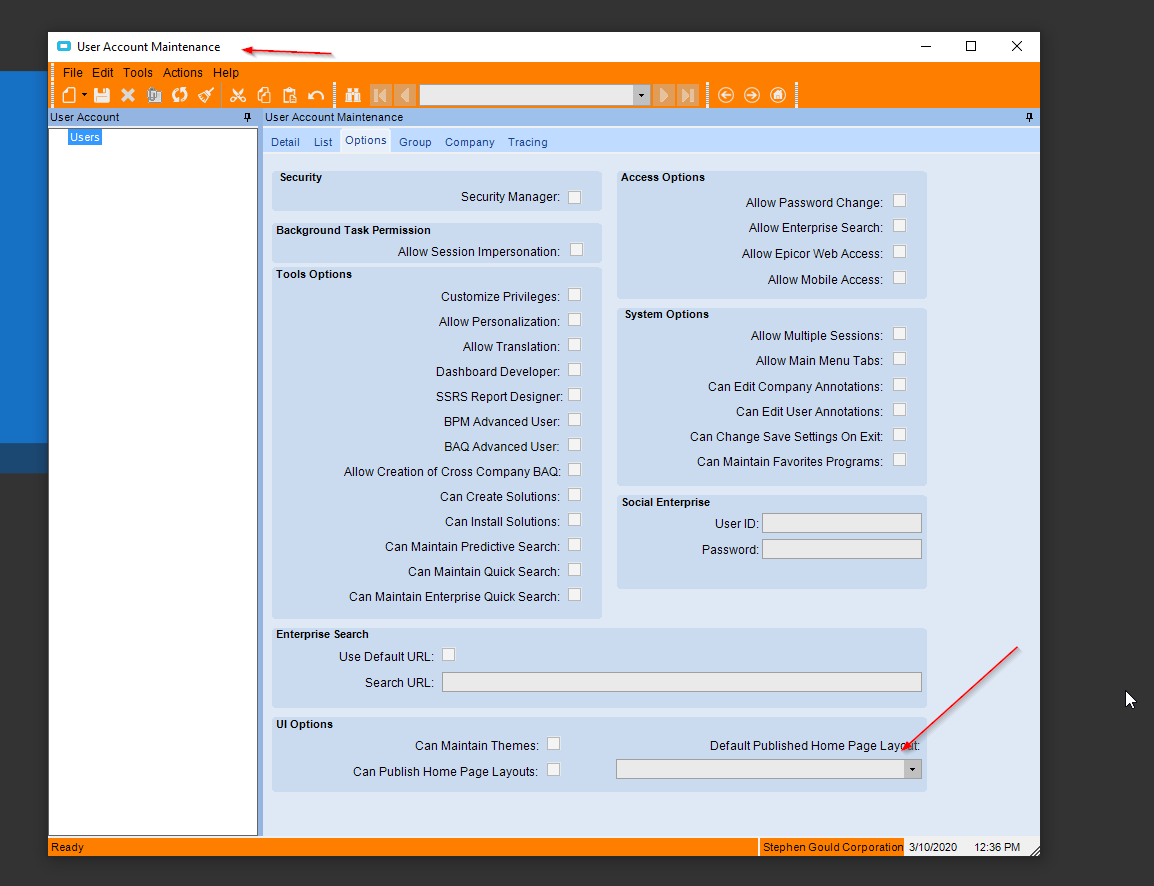

In User maint that field updates Ice.SysUserFile.DefaultHomepageLayoutID with the name of your layout however directly updating that did not seem to launch the correct layout. Updating from within user maint didn’t seem to apply it either.

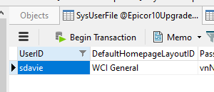

And can confirm it is set in Ice.SysUserFile

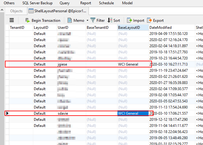

Found it! Ice.ShellLayoutPersonal is the table we want to put the ID on. I forced “WCI General” into BaseLayoutID and then it loaded the layout ok. Not sure why but there are duplicate records in this table but without the “LayoutID” key filled in. Not sure if that’s what breaking it?
Anyways I have the parts I need to fancify this. We need the “LayoutID” from “ShellLayout” filled into “BaseLayoutID” in “ShellLayoutPersonal” so BPM land here we come.
