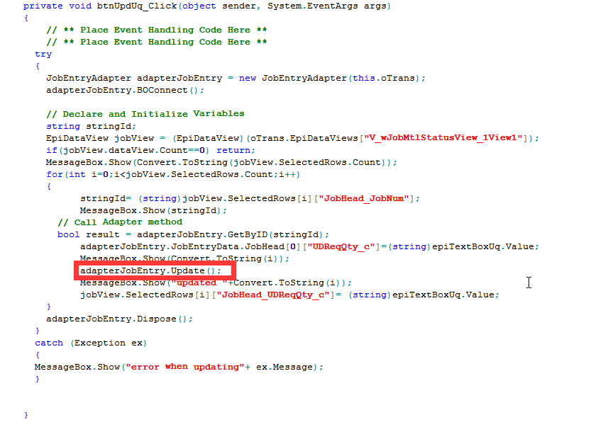

I am going to update the JobHead field according to the selected row in a job list grid by JobNum. when i selected multi line, the jobHead field can be updated successfully until move to the last selected row.
I set messagebox to show if the code works, and it does show the both message of before and after. but the Jobhead field against the last selected row is not updated.
Can anybody help me to check ? I am afraid I will be crash
Where are you calling this from? Is this in a dashboard? Are you sure the dashboard isn’t making the changes on it’s own? What happens if you hit “save” right after you loop through with the button?
Thanks for your information.
I can update all successfully except the last line selected. Fox example, I can update 4 when I selected 5 rows.The grid is customized Job Status Maintenance gridlist.
What I’m getting at, is I don’t think your custom code there is doing the updating. I think the screen is doing it on it’s own. Comment out the update, the and just loop through the dataview and change the values. I would bet that it saves it. The last line if you foreach loop is setting the View value to the string, then when you change rows, the screen is doing the save for you.
