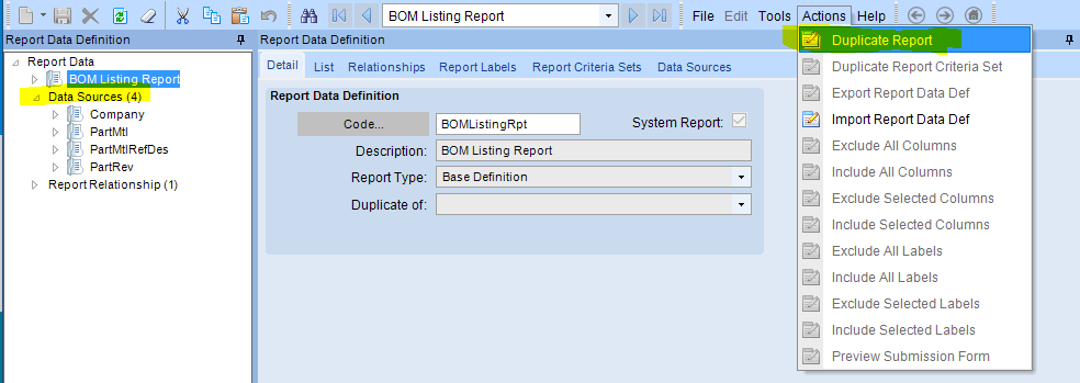

Go to Report Data Definition menu.
Search/Open: BOMListingRpt
(This is the Data Definition used by BOM Listing Report.)
You can’t alter the “out-of-the-box” RDD… so you need to go to Actions > Duplicate Report. Save it with a new name (ie. BOMListingRpt_XXX)
