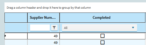

Is there a way to add a checkbox that is linked to a line of a BAQ or Dashboard? I have this dashboard i want to allow a user to check the box when they finish a task outside of Epicor. Doesn’t have to do anything, just be a checkbox. I used an extra field from the BAQ to add this column.
I tried using Application Studio but can’t seem to get the checkbox into the Grid.
