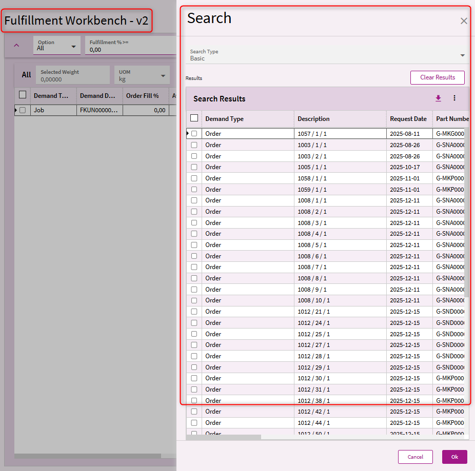

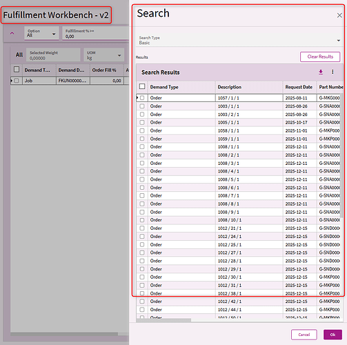

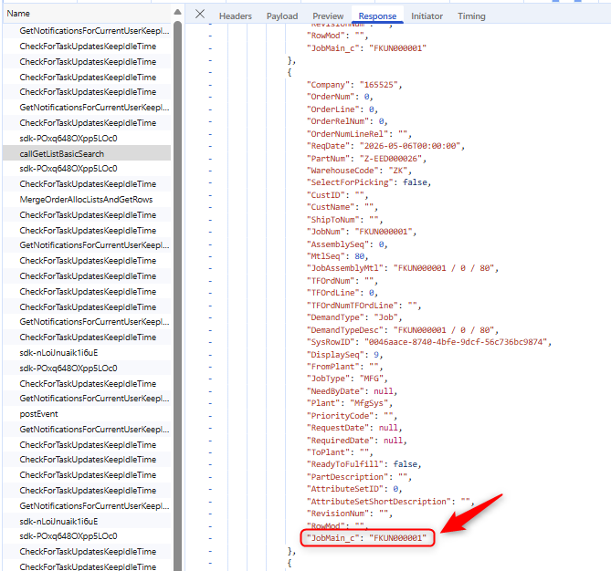

I’ve successfully added a column JobMain_c through the BPM (see 1st photo). However, I do also need to add this column to the Grid which I can’t find, tried to look into OrderAllocEntry, but there is nothing except widget called search-show. But no luck adding column through this widget.
Any ideas where can I find the app of this search grid (see 2nd photo) so I could add a column?
Thank you.
It’s not something you can edit. The json for this is returned from MetaFX.GetSearch.
If you’re brave, put a bpm on it…
