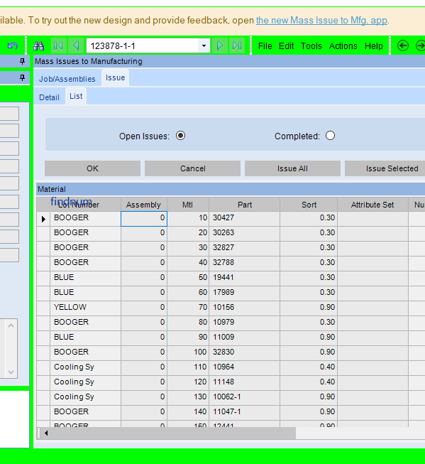

On our Job Materials we populate the Find Number (JobMtl.FindNum)
I’m trying to get this to show up in Mass Issue to MFG to help us selectively issue easier.
I’ve been messing with Method Directive, but cannot get the lookup to work correctly.
I will be replacing the LotNum field in the grid with the FindNum. I can do this with a static value successfully.

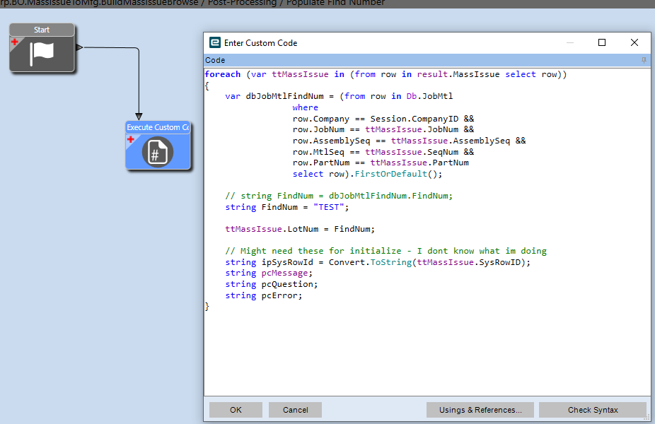

Trace log is pretty simple without customizations.
foreach (var ttMassIssue in (from row in result.MassIssue select row))
var dbJobMtlFindNum = (from row in Db.JobMtl
where
row.Company == Session.CompanyID &&
row.JobNum == ttMassIssue.JobNum &&
row.AssemblySeq == ttMassIssue.AssemblySeq &&
row.MtlSeq == ttMassIssue.SeqNum &&
row.PartNum == ttMassIssue.PartNum
select row).FirstOrDefault();
// string FindNum = dbJobMtlFindNum.FindNum;
string FindNum = "TEST";
ttMassIssue.LotNum = FindNum;
// Might need these for initialize - I dont know what im doing
string ipSysRowId = Convert.ToString(ttMassIssue.SysRowID);
string pcMessage;
string pcQuestion;
string pcError;
ttMassIssue.LotNum = dbJobMtlFindNum.FindNum;
I tried that line of code earlier but getting an error. I dont know what its looking for. Same thing with message box.

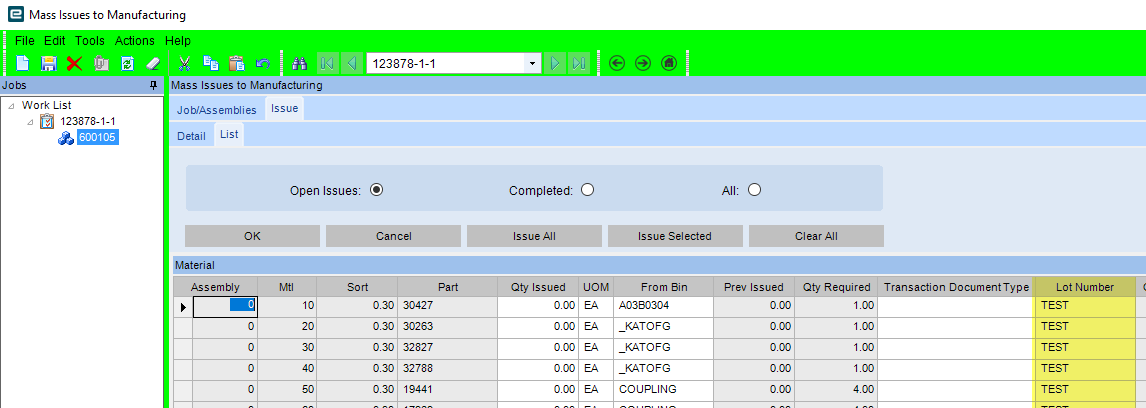

If I use a static value it shows up ttMassIssue.LotNum = “TEST”;
Anything else from JobMtl throws error.
Maybe missing Null check?

Sounds like that object or that property is null at that point. Better check and dig a little deeper.
Still trying to figure out what it wants. Can get the other info fine.
Able to get ipSysRowId which I believe BO wants so it can join JobMtl.
So nothing can be used from the dbJobMtlFindNum var. I think I need to use a GetRows method or something to do my lookup. I’m searching but not really sure how to simply get results from another table that are joined from my db.results
Your approach is perfectly valid, you should probably check those tt Variables to make sure they are what you expect them to be, because for some reason you aren’t getting back any rows.
Also check the companyID, make sure that table has it populated.

I’m going to put it some more static values and see what happens in a message box.
I’m thinking Bool, Int, Strings are causing problems.
Just changed a couple from == to = for testing.
Victory!.. well for one result.

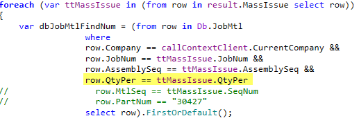

It hates these two. PartNum should be string in both. MtlSeq should be int in both, its called SeqNum on the other table though.
Yup thats the final issue.
Cheated and matched using QtyPer just to get some different output.
So convert the types and try again !
