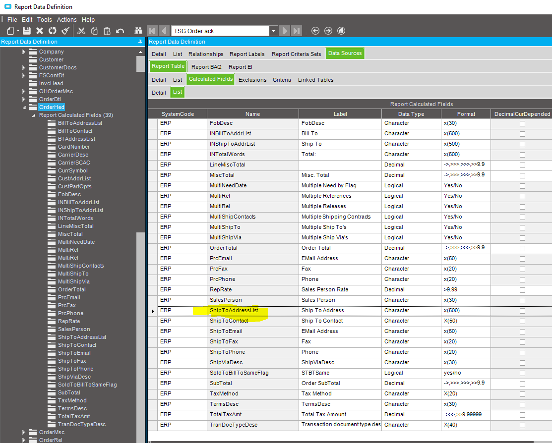

We are testing the Freight Forwarder address fields and would like to display these when printing the Order Ack. When I look at the RDD, I don’t see these fields and would like to add them. The basic ShipTo addresses all show up in calculated fields under OrderHed. Is there a way for me to add the FF address to this calculated area? Or, do I need to add a new table to the RDD?
Thanks.
Check the “Exclusions” tab. I have not checked but assume they would be there. You may just need to make them available in the output.
Somehow I missed it at first glance. Thanks!
