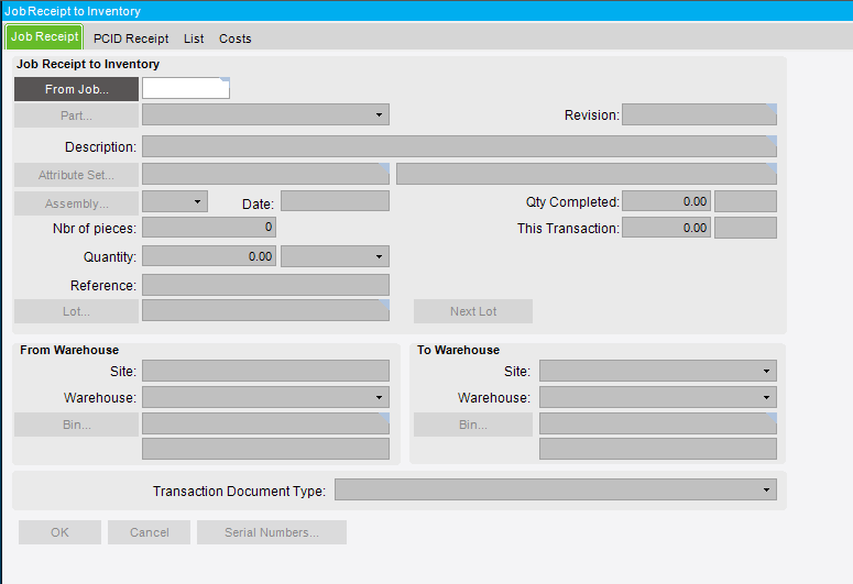

Hi Epicor Community, is there anyway to add in an UD field for prod qty in the job receipt to inventory page?
Your guys help is much appreciated.

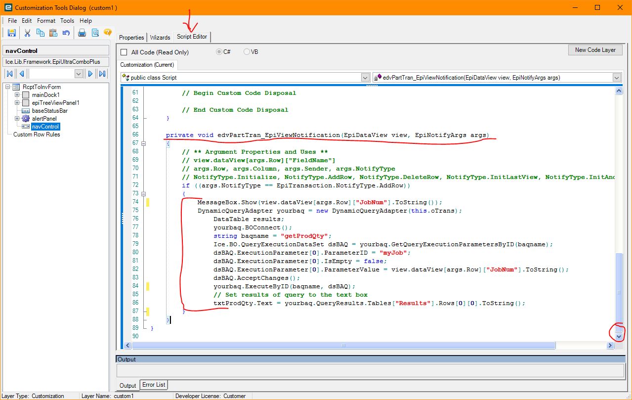

Insert a new text box on your form. Let’s call it txtProdQty. Use this bit of code to get the prod qty out of your BAQ and into the txt field:
private void edvPartTran_EpiViewNotification(EpiDataView view, EpiNotifyArgs args)
// view.dataView[args.Row]["FieldName"]
// args.Row, args.Column, args.Sender, args.NotifyType
// NotifyType.Initialize, NotifyType.AddRow, NotifyType.DeleteRow, NotifyType.InitLastView, NotifyType.InitAndResetTreeNodes
if ((args.NotifyType == EpiTransaction.NotifyType.AddRow))
MessageBox.Show(view.dataView[args.Row]["JobNum"].ToString());
DynamicQueryAdapter yourbaq = new DynamicQueryAdapter(this.oTrans);
DataTable results;
yourbaq.BOConnect();
string baqname = "getProdQty";
Ice.BO.QueryExecutionDataSet dsBAQ = yourbaq.GetQueryExecutionParametersByID(baqname);
dsBAQ.ExecutionParameter[0].ParameterID = "myJob";
dsBAQ.ExecutionParameter[0].IsEmpty = false;
dsBAQ.ExecutionParameter[0].ParameterValue = view.dataView[args.Row]["JobNum"].ToString();
dsBAQ.AcceptChanges();
yourbaq.ExecuteByID(baqname, dsBAQ);
// Set results of query to the text box
txtProdQty.Text = yourbaq.QueryResults.Tables["Results"].Rows[0][0].ToString();
When you are done, make sure to remove or comment out the message box. You don’t need to see that anymore. Then save your customization and set it as the default customization from the menu maintenance. That should do the trick. You may want to set the text box as read only and/or give it a label but that’s all just pretty stuff you can figure out.

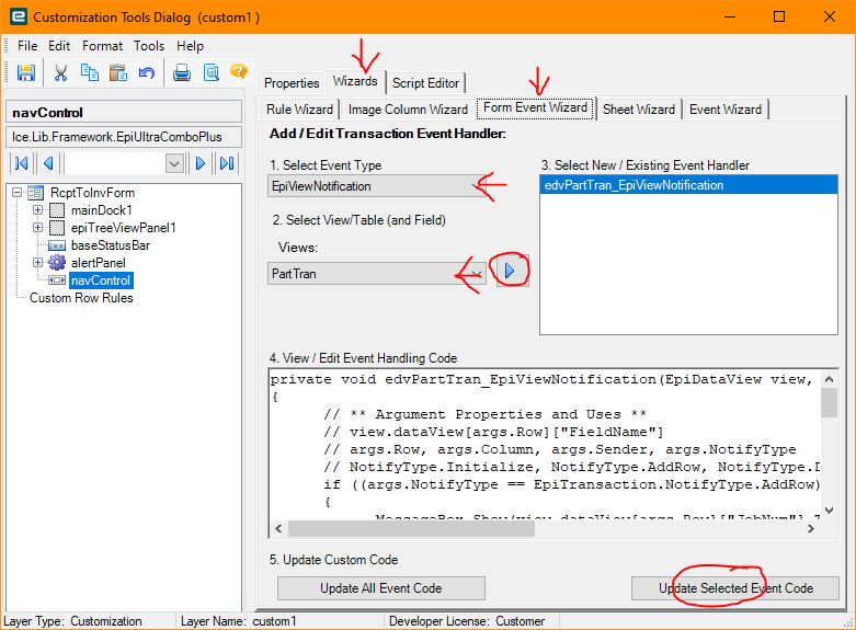

Go to Wizards > Form Event Wizard. Choose EpiViewNotification as a triggering event. Choose the View you want to use as the trigger. In this case, the PartTran view has the Job information we need to send to the BAQ. Click the Blue arrow to make a new handler. Then at the bottom, click Update Selected Event Code. This puts some code outline into the Script Editor for you.
Just paste in that code inside the if statement. Now go to File > Save Customization. Give it a cleverer name than custom1. Now close the form and customization window. Leave Developer mode on, and open your form again. Now you can open the form with your customization to test it out.

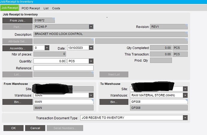

Hi @NateS thanks for the screenshot, I’ve followed your step but it seems the prod qty is not showing, I’ve redo the steps a few times, am I missing something?

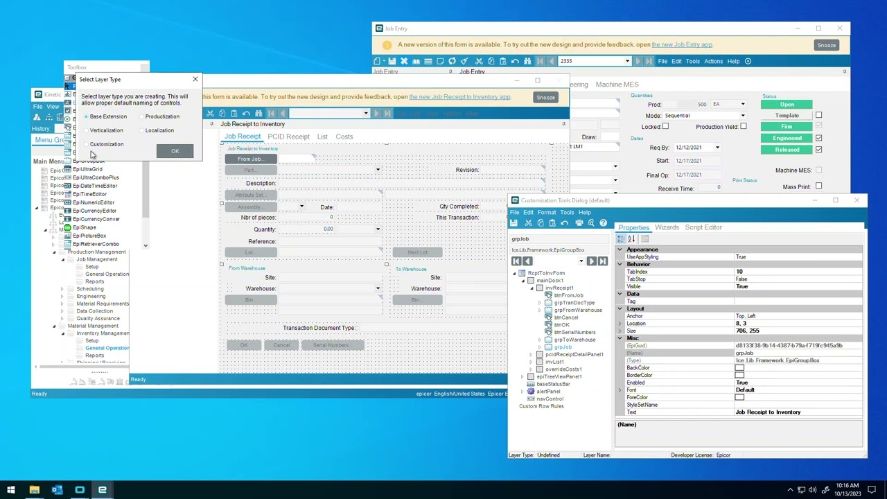

Made a quick video showing how it is done
Customization File (2023.2.3):
App.RcptToInvEntry.RcptToInvForm_Customization_JobHead_FKV_CustomExport.xml (22.0 KB)
