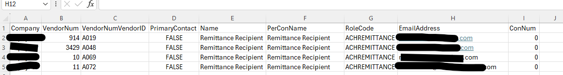

Here is an example of my DMT file. Anyone tried to do this before?

I skip VendorNum also, FYI. (Your column B)
And I skipped PerConName - I saw no need for that.

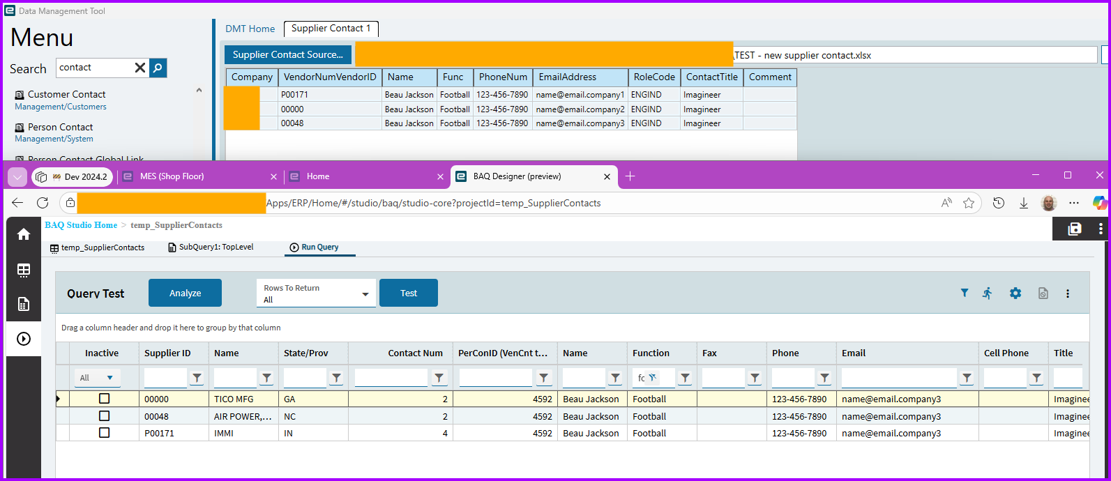

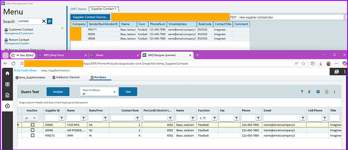

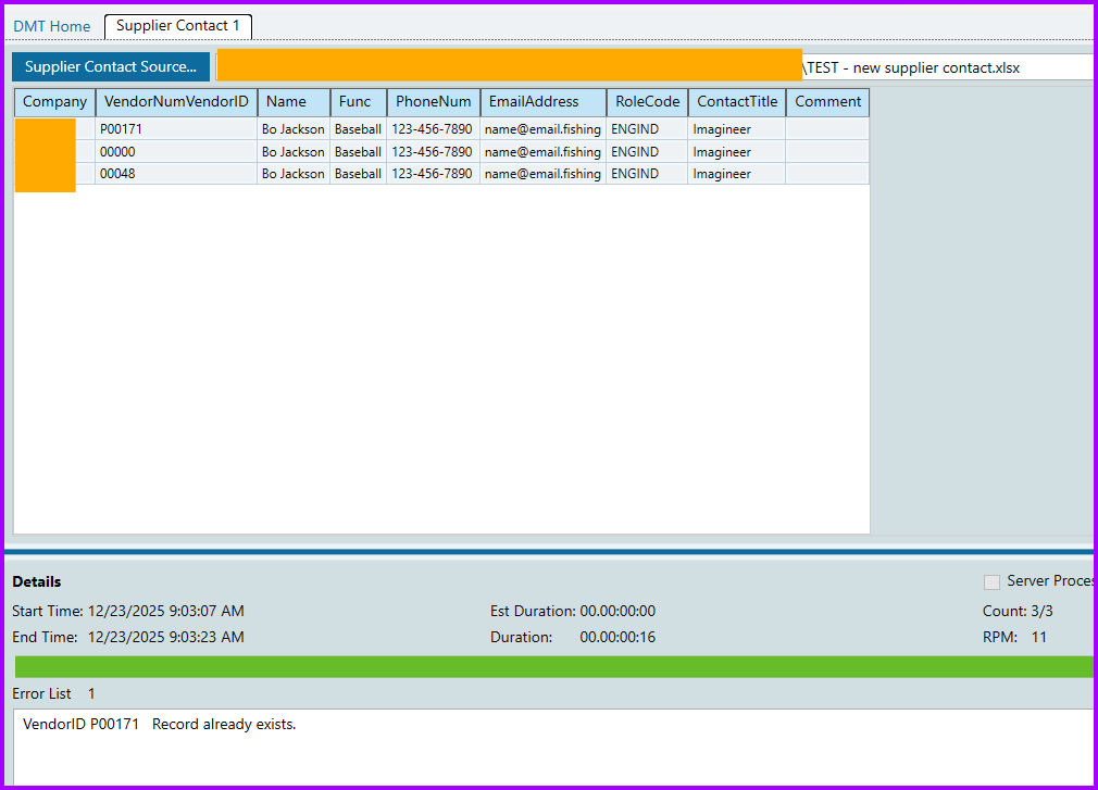

I tried removing the VendorNum & PerConName as well but still no luck. Seems if the Name is the same as a prior Person Contact it adds a link to the existing contact and updates all the links with the last records data (in my case the email address).
Aha, I see the light! Yes I am seeing this too! Oh man.
But as you said, you get the freedom to make duplicates in the UI. Not duplicates for that vendor, but in general. But the DMT acts differently.
