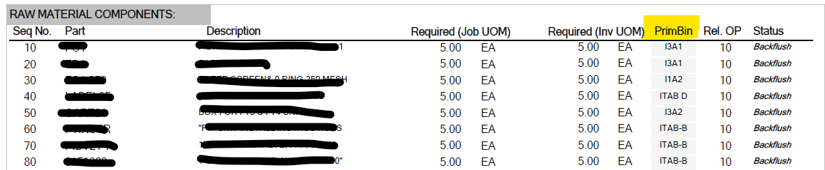

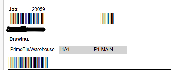

Has anyone been able to add the PrimBin to both the Materials and Primary part on a Job Router. The issue is you cannot make a dual relationship to the same table in the RDD. We have a need to have the BIN for the materials and the upper-level part. Just curious if anyone has found a solution to this.

I do not see a way to get the primary part to the PlantWhse where the PrimBin is stored. I currently have the relationship going from the JobMtl to PlantWhse. Maybe that is the incorrect relationship to get the linked table to show up. Thoughts?
I don’t know if it’s a great option, but you could set the PlantWhse relationship to be Company to Company and then you’d return all your PlantWhse records. Then you could use the query in the RDL to join the same table twice, once from JobHead and the second time from JobMtl. Not sure how well that performs. Or you could write the Job part Primary bin to a UserChar field on JobHead. Those are already available and you could write that using a BPM maybe even when the Job Traveler is printed. Just a couple of ideas.

We have the primary bin on our job traveler and I tied the job head to the part plant (both part and plant are on the job head) and then part plant to plant warehouse (Company to Company, Plant to Plant, PartNum to PartNum, and PrimWhse to WarehouseCode) but it’s pretty easy for us because we only have one warehouse per plant.
As for why we have it on the job traveler I believe it’s to make it easier to put it in the primary bin once the job is completed and not a random bin. I’ll be honest though I just completed the request and didn’t dig into it as much as I likely should have.
That works fine, unless you want to add Bins to the Materials also. The previous idea of adding it to the company may work. Still testing out how it performs etc.
