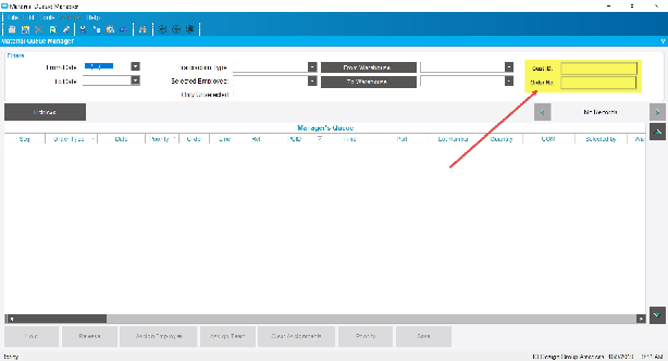

Add two search filters on Material Queue Manager with Customer ID and Order ID
Due to the heavy default data load (search result on the data grid) on the Material Queue Manager screen, we’d like to offer more search criteria (Customer ID, Order ID) in the Material Queue Manager so that a user has an ability to retrieve the target order records quicker based on customer ID and order number. This will improve the distribution process and increase the system response time to users.

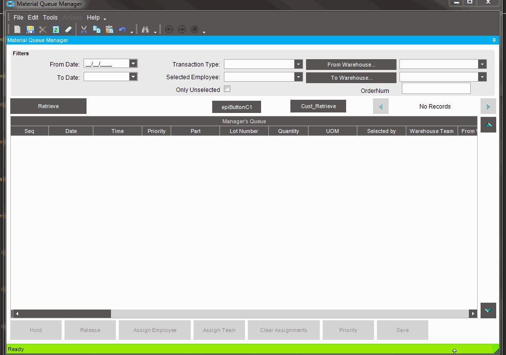

• Added 2 Textbox “Cust ID” and “Order No”
• Added custom Button “Retrieve” (Native “Retrieve” button is hidden)
• When user clicks on the “Retrieve” button, results will be shown based on selection criteria along with newly added search criteria fields (Customer ID and Order No), It will populate the results as per our expectation but there are certain issues which are mentioned below.
• Behavior
Step #1: Enter the order number 1012248
Step #2: Only the matched records based on “Cust ID” and “Order No” returned and bound them with the result data grid. (It returned only the selected records from the database and bound to data grid)
• To achieve this, I have used custom BAQ to retrieve records from the database and displayed in the data grid but doing so we are losing our native Epicor behavior, controls and events and also getting unwanted error messages like “Object reference not set to an instance of an object.” And “Key not found: 'Quantity' Parameter name: key”. Even we couldn’t get right-click options.

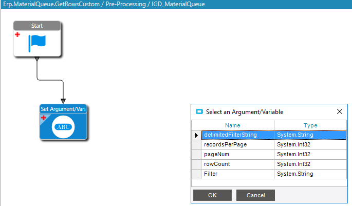

• Even BPM method directive also not accepting any additional reach criteria apart from its native search criteria
delimitedFilterString = "[OrderNum]1012428~"

When you click the “Retrieve” button in Material Queue Manager, it fires “Erp.MaterialQueue.GetRowsCustom” method but it doesn’t accepting delimitedFilterString = "[OrderNum]1012428~" parameter
delimiter string does not have order number filter.
