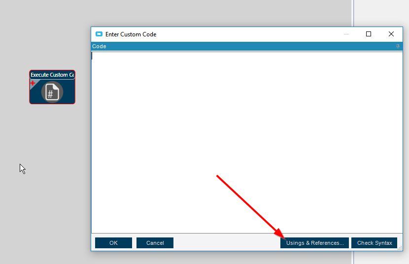

It only comes into play if you are adding a Custom Code widget, which it doesn’t appear that you are…

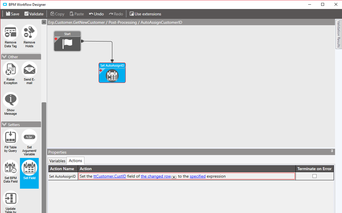

I create a new Post-Processing for an existing Method…
Yep, but you’re not utilizing the Custom Code widget within the BPM. You would only ever need to specify custom references if you plan on writing c# within this BPM, but from your screenshot, you’re just utilizing the BPM widgets. In that case, there is no need to specify custom references.
Like @Aaron_Moreng said, you don’t need it if you aren’t using custom code, but if you are, it’s actually in the custom code block editor.

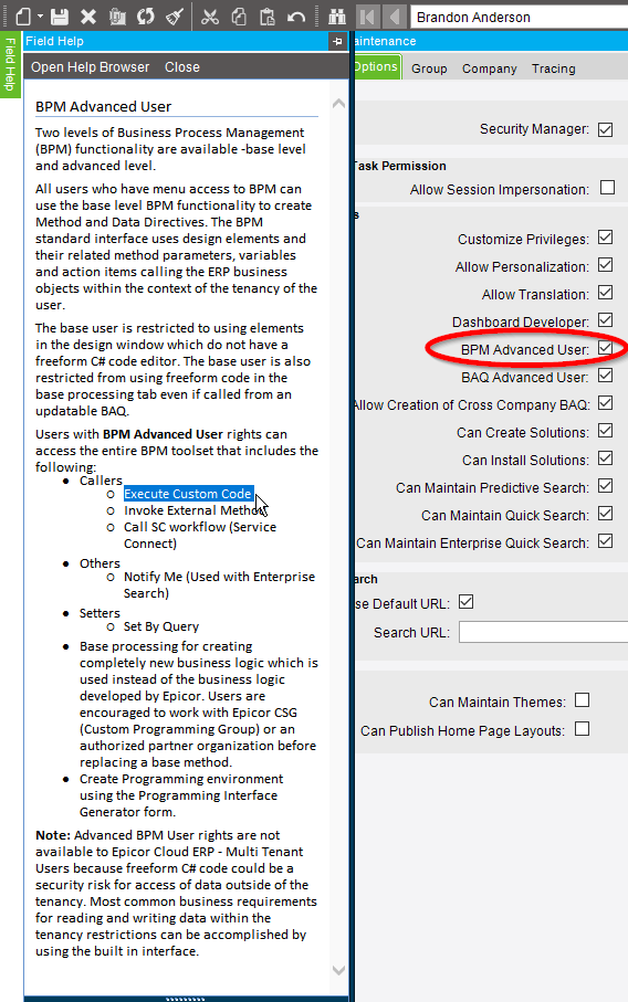

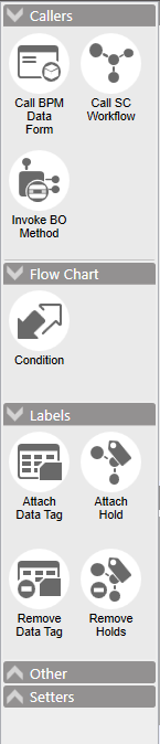

Are you a SaaS user? I don’t believe SaaS allows one to write custom code in BPMs
Dedicated Tenant users have the ability to write custom code, but I don’t believe Multi-Tenant users can
