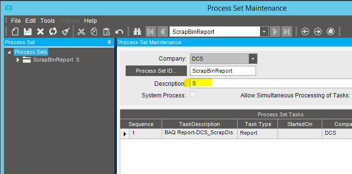

I’ve seen this several times before myself, and it appears to have something to do with either the BAQ report description or the process set description. A possible resolution is making either or both descriptions a single character, and then saving it.
