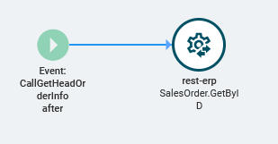

I used a rest-erp component that fires after the “CallGetHeadOrderInfo” event.
The “CallGetHeadOrderInfo” event occurs after you enter in a valid Order in the ShipHead.OrderNum field.

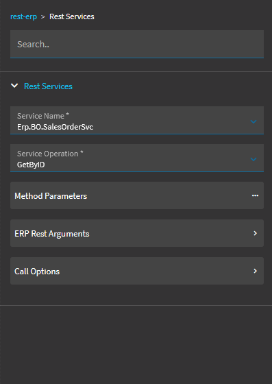

I setup the rest-erp component as follows
Under Rest Services
Service Name: Erp.BO.SalesOrderSvc
Service Operation: GetByID

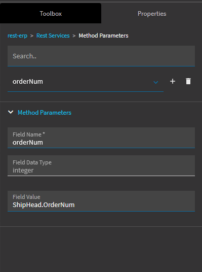

Method Parameters:
Field Name: orderNum
Field Data Type: integer
Field Name: ShipHead.OrderNum

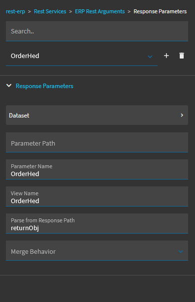

Response Parameters:
Parameter Name: OrderHed
View Name: OrderHed
Parse from Response Path: returnObj
