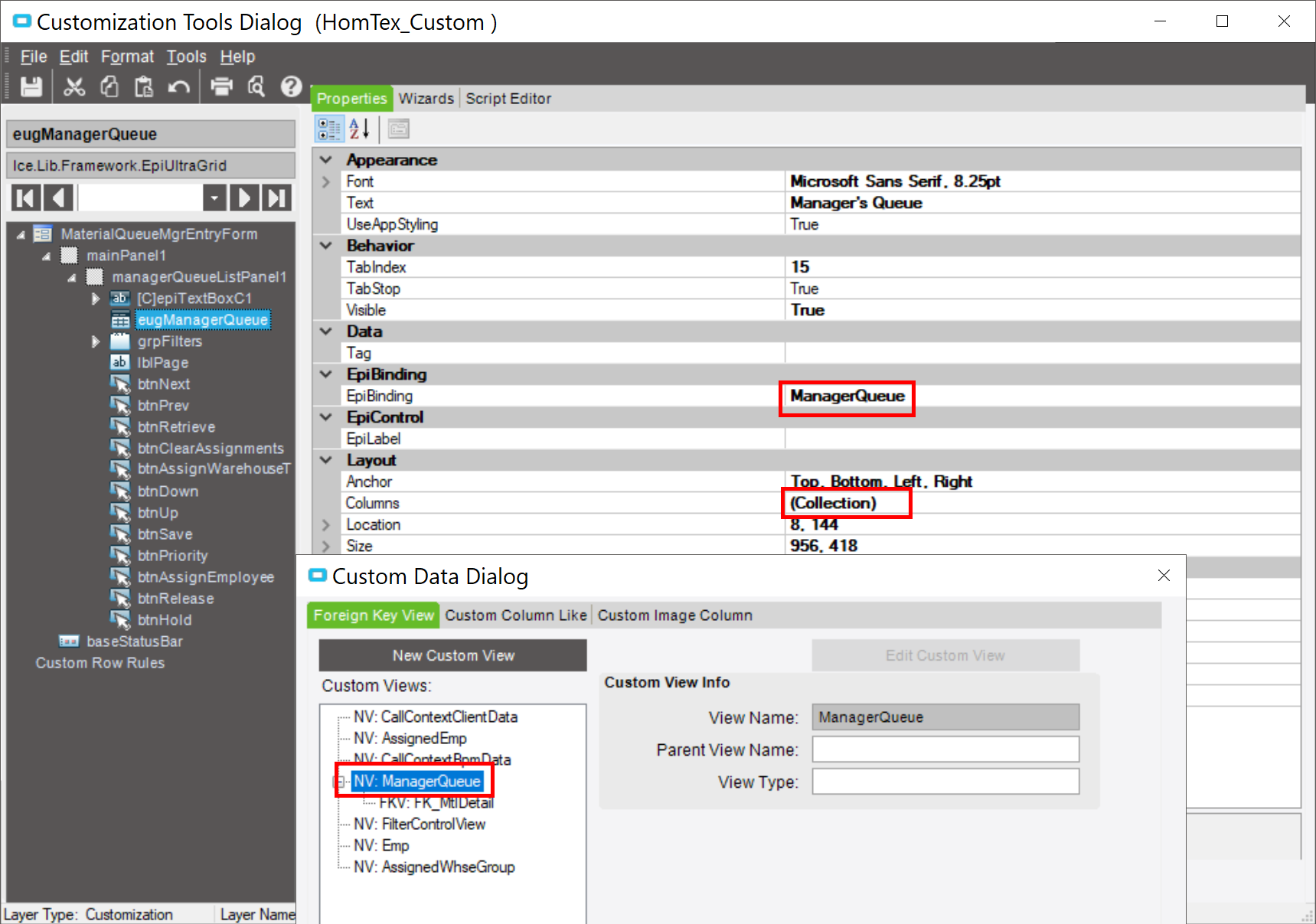

Is is possible to add a field to the Epi.Ultra.Grid on the Material Queue manager and Material Request queue without major customization? The EpiBinding for the grid is named “ManagerQueue” but I’ve seen no way to edit this. I can add tables using Data Tools and Custom Views but that would only allow me to add a field outside of the Ultra Grid since it must be “ManagerQueue” attached to the UltraGrid and not another view.
