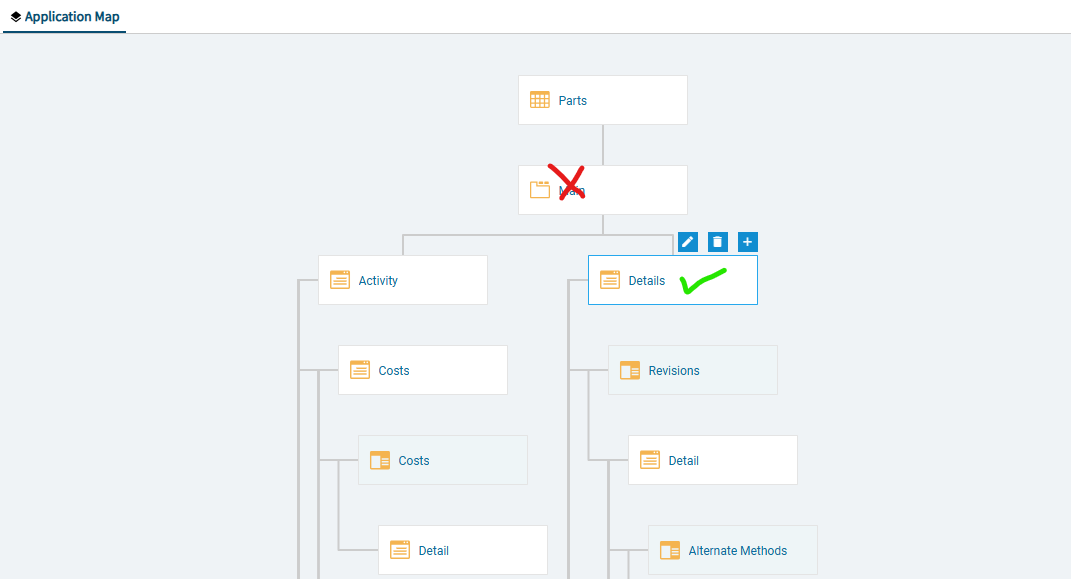

Have an elementary question. I would like to insert a group box on Part maintenance and move Part and description into there along with a new text box. I am an old Windows desktop app programmer where we can drag things from tool box on to the form. That doesn’t seem to work here. Can anyone tell me the secret on inserting a group box and rearranging the Part and description into this new group box? I have been trying, with my knowledge, for several hours and have been unsuccessful.

Are you editing the right page?
Dragging things into the body of MAIN page won’t work. You need to do this in the DETAILS page.
That was it. David Camlin was spot on. Thanks guys!!!
