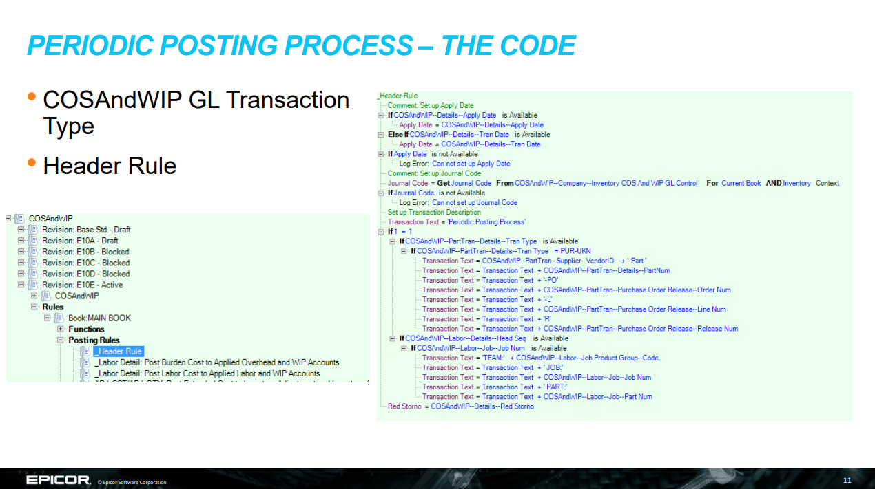

I’m new here and obviously don’t know how to upload a file. send me a message if you want me to send you a PDF that contains a couple of pages from a workshop at Insights 2018. I was able to use it to modify my COS/WIP postings from Periodic Posting Process
PM sent…

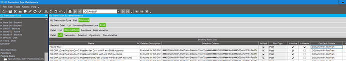

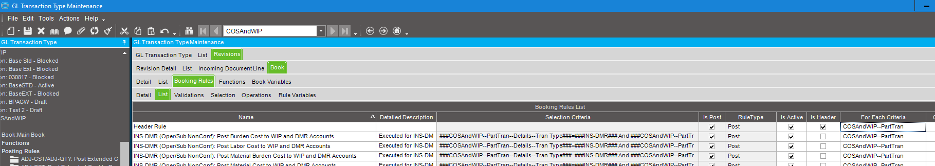

OK; so I looked at the Header Rule in List view, and noticed that the “For Each Criteria” just had “COSAndWIP” only. All the other rules either had “COSAndWIP–PartTran” or “COSAndWIP-- Labor” entered.
I was able to edit the Header Rule’s entry to “COSAndWIP–PartTran” and now I am able to get “PartTran–TranType” as an ABT Field path.
I am not sure if I should be changing these values here, as there is no documentation; if anyone has any wisdom here let me know. For now I am just going to complete the coding and see where it blows up…
Was able to only partially complete the edited header rule. I also need to figure out how to bring in the Labor Details, as it seems to be an either one or the other option. Also; I am not able to grab Part# or Vendor ID…
