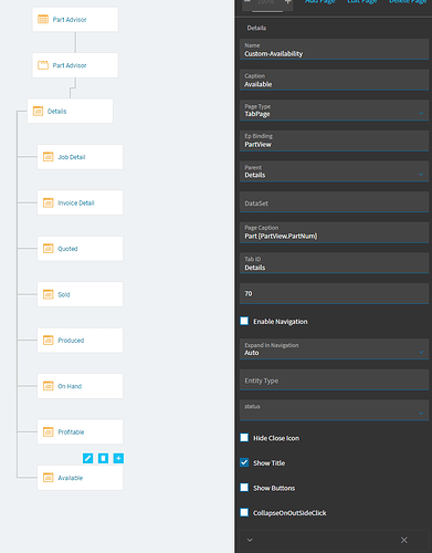

Hi all. Before 2023.1.5, I had added a custom “Available” tab in the Part Advisor menu structure. It looks like Part Advisor got a bit of a face lift and my TabPage is no longer present post-upgrade. Other aspects of my modification are still present like custom events and a view, but the actual tab page is nowhere to be seen.
Now that I’m trying to re-add the tab page, I cannot manage to make it visible in the left-hand menu tree. See my application map below:
I was able to add it to the tab strip on the Details tab page, but still no reference to it in the tree. What am I doing wrong?

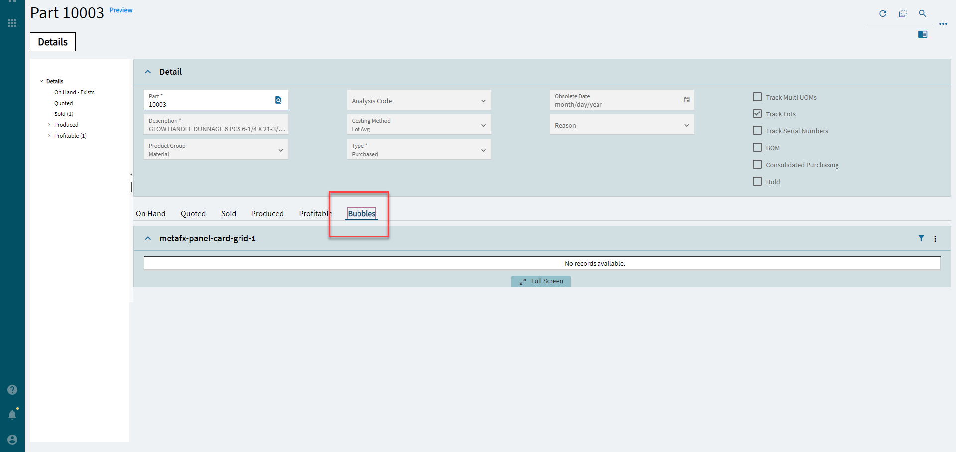

Not sure if this is a sufficient workaround for you, but you could add a tab with the rest of them down here:
Yeah, that’s what I ended up doing. Just a bummer I can’t add it to the tree.

I learned the hard way to not add the page first.
If I add a tab it cannot find the new page I had previously buit.
If I add the tab and then choose create new page from the drop down it works.
Thank you for the tab idea! I could not get the application to find my page no way no how before I did that.
