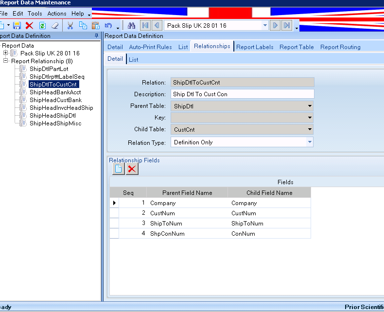

I have a duplicated data definition for a pack slip crystal report…i am trying to add the table CUSTCNT…the relationships are COMPANY, CUSTNUM, SHIPTONUM and then CONNUM goes with SHPCONNUM…(Note, this generates data perfectly in a BAQ).

Make sure you also update the table links in Database Expert in Crystal. Since you added a new table you will need to bring the new table into the Report Data Set so you can add needed fields to your report.
