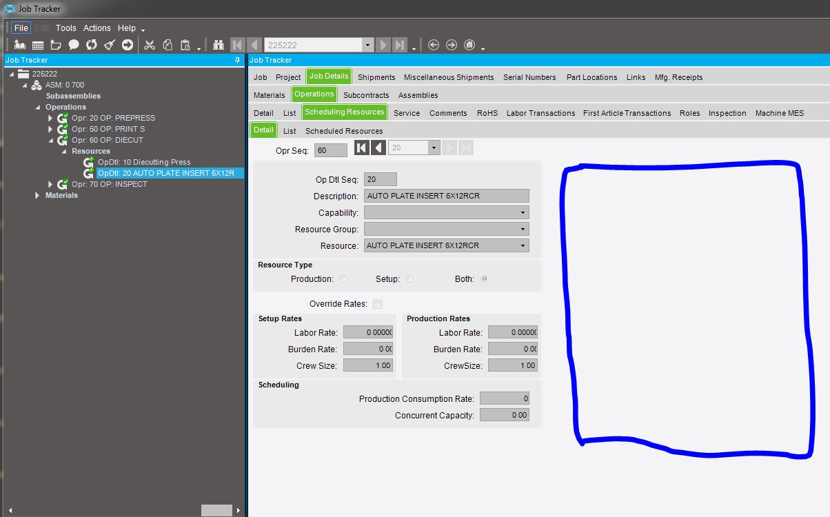

Yesterday, I ahd a kind perosn give me his code that he uses to add an image to the part. I however, want it in Job tracker for the resource. Here’s a pic.

First, I am in Test and not Live. My coding skills are very limited. So, forgive me for what may be a simple question, but how do I change the DataView to the right view for me? Obviously the part_DataView is not right for me. I have it set up where the jpg are labeled to be identical to the resource ID.
Well, I figured a lot of this out, I think. Here’s what I came up with. Am I missing anything?
