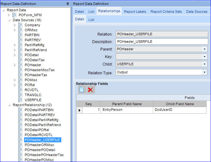

Under the assumption that the Buyer is also the “Entry Person”… I did this by linking the UserFile table to the RDD.
Add UserFile Table to RDD. Review excluded columns…
Add new Relationship: POHeader to UserFile
Relationship Fields: EntryPerson = DcdUserID

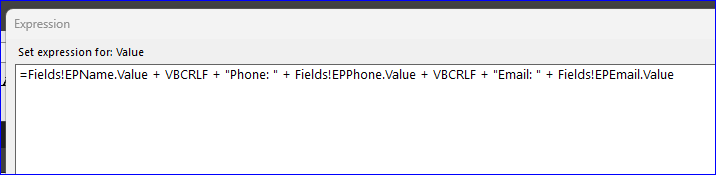

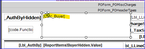

The Report gives your a “Calc_Buyer” field:
I altered the expression to use the new EP “Entry person” fields:

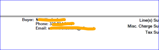

Spits out like this in the final PO:
