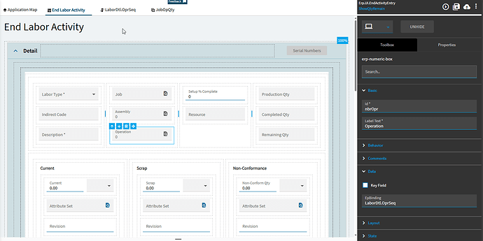

So I am adding three read-only text boxes to the End Labor Activity application that populates with the following information as reference for the user:
  1. Total operation prod quantity
  2. Quantity completed on the operation
  3. Quantity remaining on the operation
So far, I have done the following:
  1. created a BAQ that supplies the information and added it as a data view
  2. Added the three text boxes, set them as read-only, and set their epbinding to .

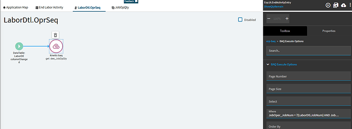

Ok! I will try creating an event…
Type: DataTable
Hook: Column Changed
Target: LaborDtl
Columns: OprSeq
I am assuming I will need to specify a ‘where’ condition under execution options which returns the baq values that correspond to the specified oprseq value?

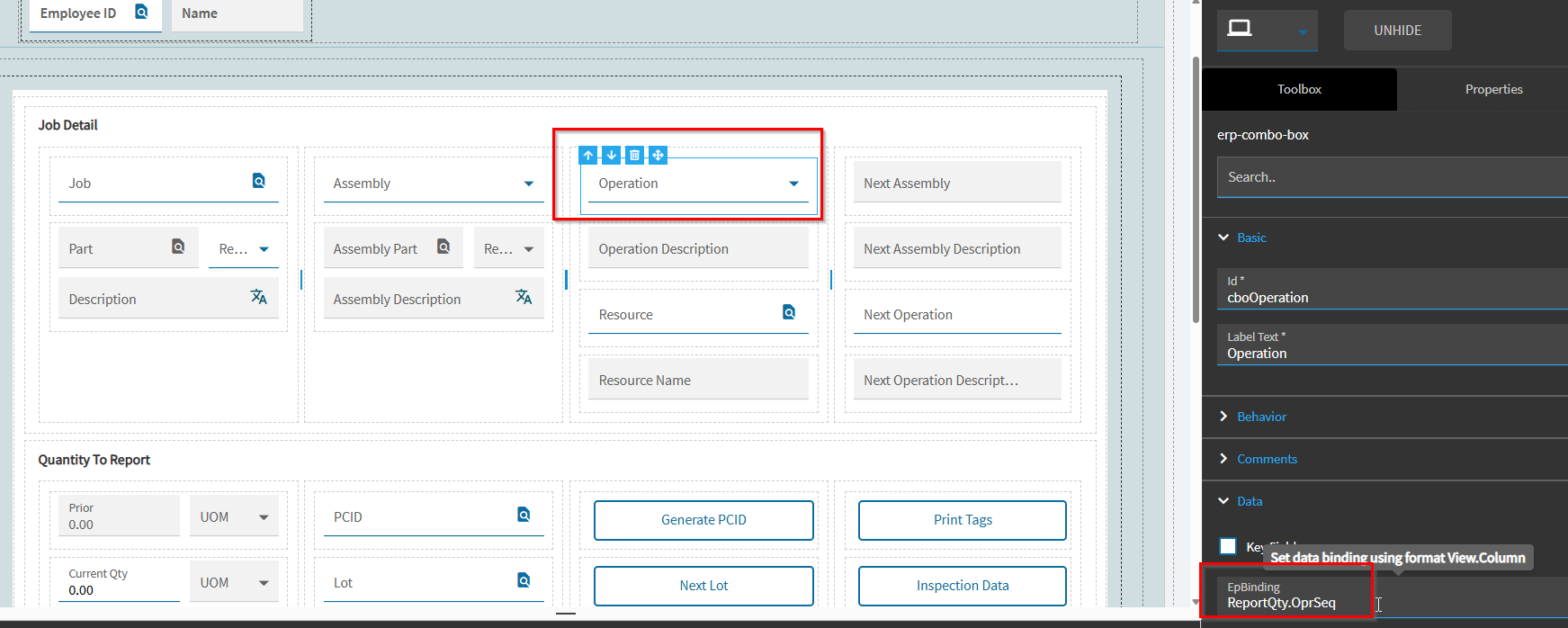

Its ReportQty not LaborDtl

So here is what I see, including the three: text fields I have added.
This is the ‘where’ condition I am rolling with: JobOper_JobNum = ?{LaborDtl.JobNum} AND JobOper_OprSeq =?{LaborDtl.OprSeq}
So if I understand correctly, I can eliminate that condition if I configure the parent child relationship between the two dataviews in the same fashion?
Oh you’re in end activity not report qty, that’s why our binding is different. Yeah I would probably just do it with parameters in your BAQ. You can map the parameter values in the kinetic-baq widget in the get event. But yeah it should also be possible if you go into your dataview and add the parent relationship there.

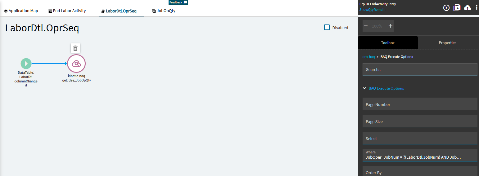

So “End Activity” application opens with the operation seq already specified, which is based the operation I have selected from the Queue in MES. Does that fact change how I should be configuring the event?
My event didnt appear to work :frowning:
Yeah if the operation is already there, you should be able to do after form on load or something like that so it pulls it in right away.
