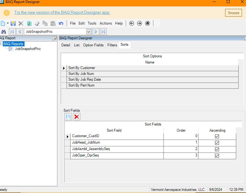

I am using the report sorting:

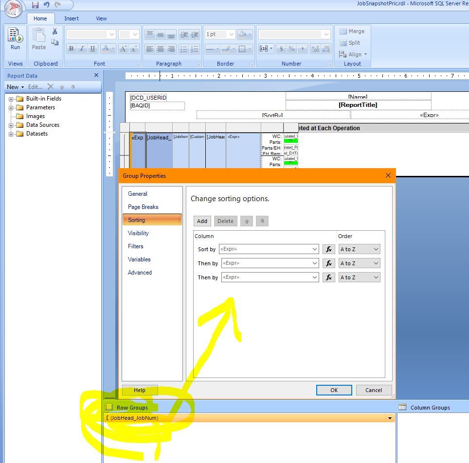

Once the user chooses a sort, the RDL file parses that out and instead of applying the sort as defined by the BAQ Report, it applies the sort here:
It the uses the expressions I posted earlier to determine the actual fields that get sorted.
