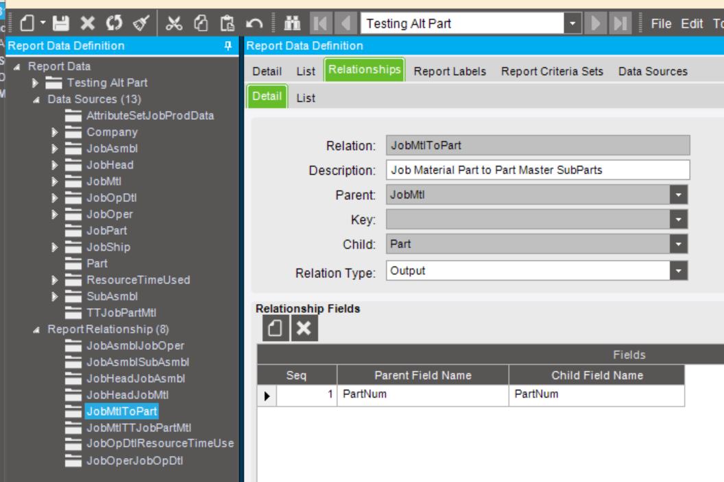

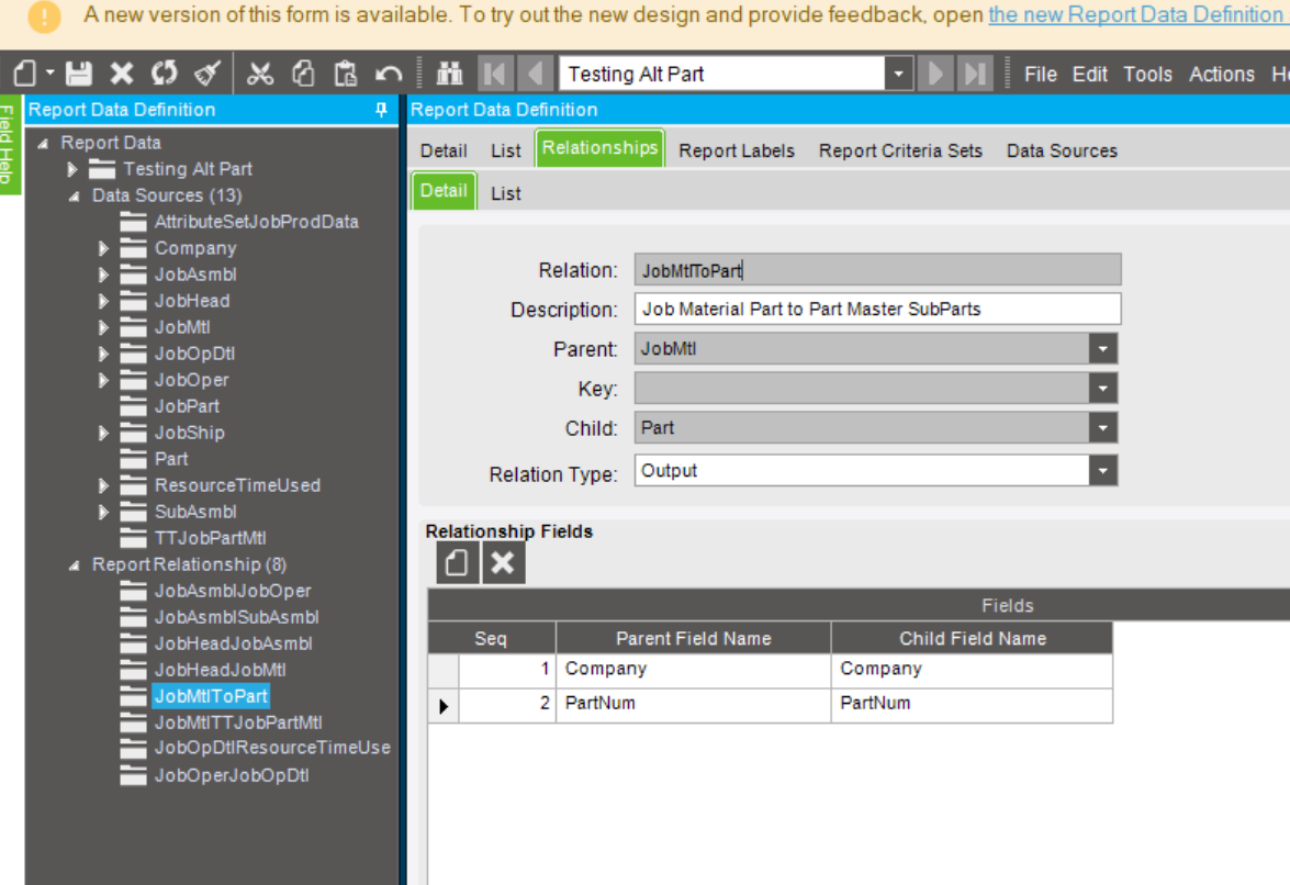

Updated RDD to add Part Table to JobMtl: Should it be Output or Definition? I’ve tried both.
Do I have to pick anything in this Linked Tables section? I thought the link came from the report relationship.

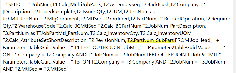

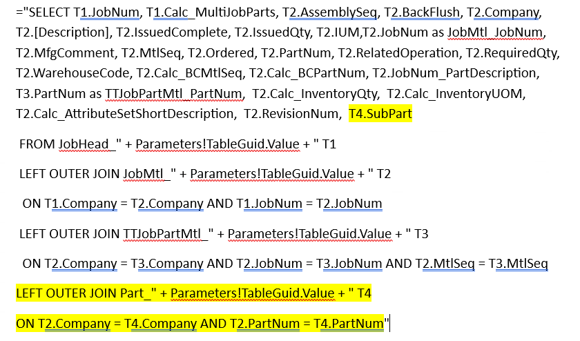

Here is my updated query on the subreport (my changes in yellow) - I get the error subreport can’t be shown:
I’ve also tried the same link but using the PartSubs table (which I didn’t think existed because I didn’t see it in the data dictionary - LOL) and I get the same error that the sub report can’t be shown

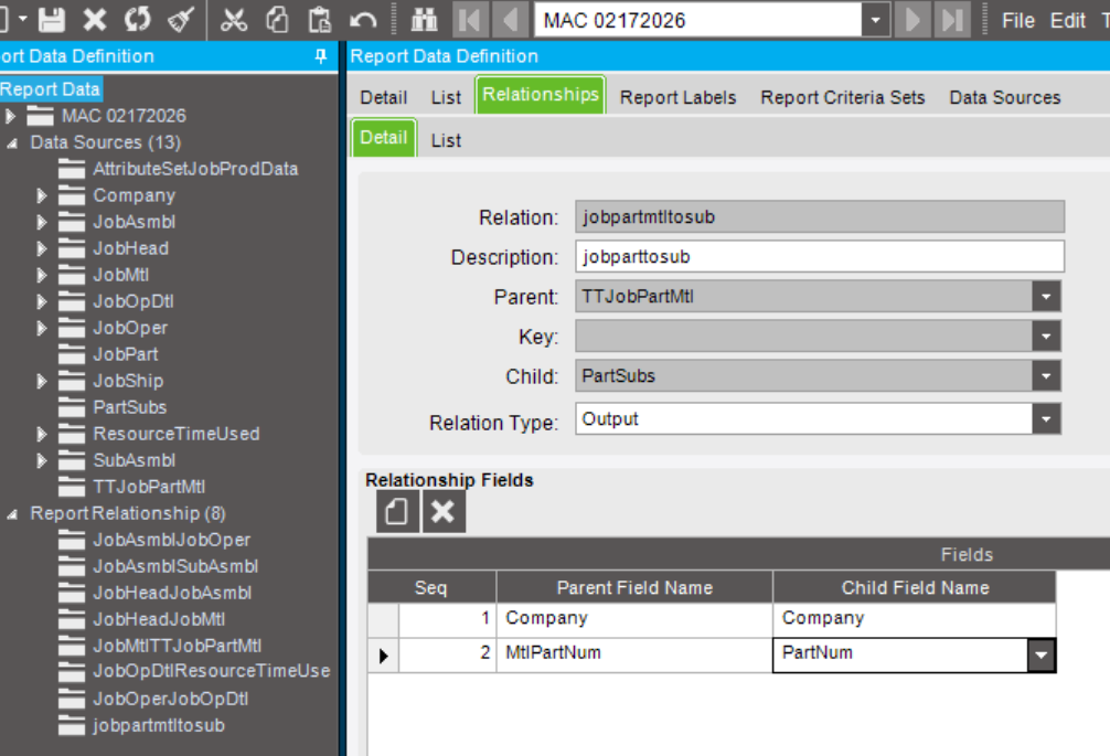

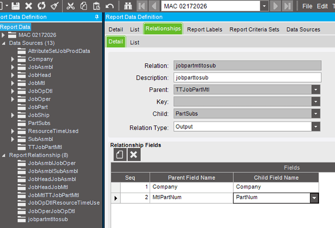

I’ve gotten a bit farther towards solving this I think. I added the PartSubs table to the RDD and linked it to the TTJobPartMtl table
Then I updated the query on my report:
        T1.Calc_MultiJobParts,
        T2.AssemblySeq,
        T2.BackFlush,
        T2.Company,
        T2.[Description],
        T2.IssuedComplete,
        T2.IssuedQty,
        T2.IUM,
        T2.JobNum as JobMtl_JobNum,
        T2.MfgComment,
        T2.MtlSeq,
        T2.Ordered,
        T2.PartNum,
        T2.RelatedOperation,
        T2.RequiredQty,
        T2.WarehouseCode,
        T2.Calc_BCMtlSeq,
        T2.Calc_BCPartNum,
        T2.JobNum_PartDescription,
        T3.PartNum as TTJobPartMtl_PartNum,
        T2.Calc_InventoryQty,
        T2.Calc_InventoryUOM,
        T2.Calc_AttributeSetShortDescription,
        T2.RevisionNum,
        T4.SubPart AS SubPartValue
 FROM JobHead_" & Parameters!TableGuid.Value & " T1
 LEFT OUTER JOIN JobMtl_" & Parameters!TableGuid.Value & " T2
    ON T1.Company = T2.Company
   AND T1.JobNum = T2.JobNum
 LEFT OUTER JOIN TTJobPartMtl_" & Parameters!TableGuid.Value & " T3
    ON T2.Company = T3.Company
   AND T2.JobNum = T3.JobNum
   AND T2.MtlSeq = T3.MtlSeq
 FT OUTER JOIN PartSubs_" & Parameters!TableGuid.Value & " T4
    ON T3.Company = T4.Company
AND T3.PartNum = T4.PartNum"

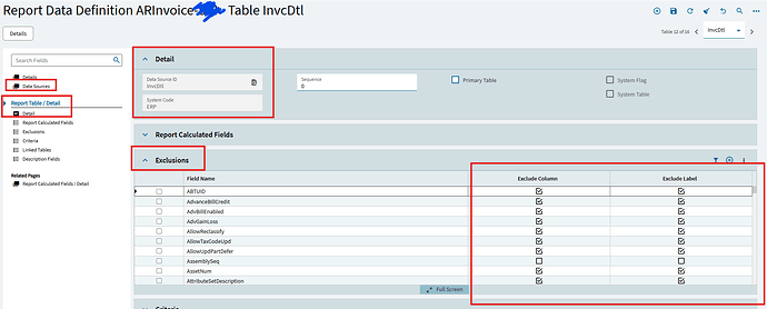

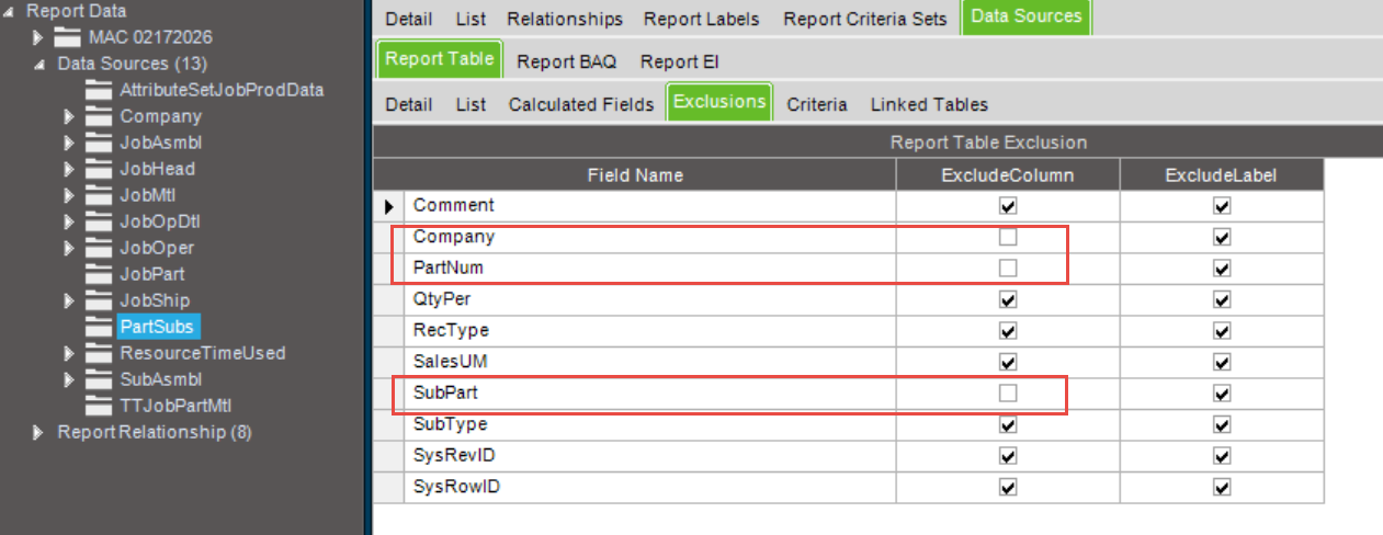

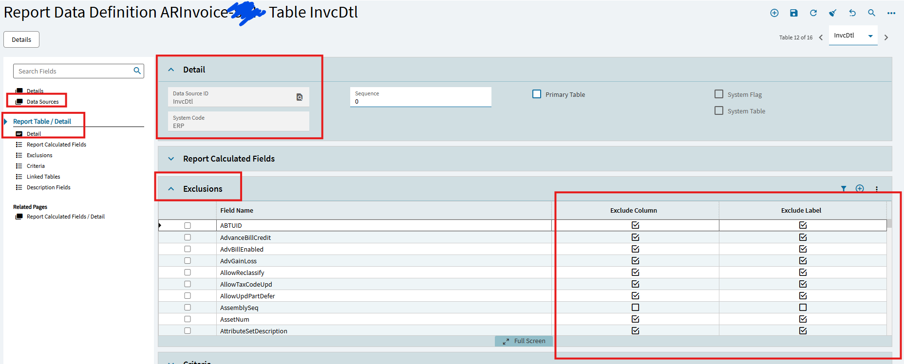

You need to have the relationship fields at minimum in the unchecked in the Exclusions tab. So Company and MtlPartNum will be in the dataset plus whatever other fields you want to show actually on the report.
@MelissaC, I never went into the fact that when you add a table to your RDD, like @Randy said, you have to go in and go to that table in the RDD and make sure that hte columns you are joining on from that new table are not “excluded” and whatever other column you want to show in the results is also not excluded so that they can be used in the query expression in your .rdl. Does that makes sense?
They are not excluded

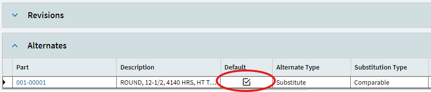

Are the Sub Parts you want to show marked as the “default” sub part on the part records?
Here are my thoughts. When you’re one a Part record, and you add a substitute part… the system writes that to the PartSub table. You can have multiple sub parts for a given Part record.
HOWEVER, the Sub Part that you mark as the “default” (and you can only pick one per Part Record) is then recorded directly onto the Part Table.
Example: as long as I check that default box…
If I then query the Part Table… that value lives on the Part Table in the SubPart column.

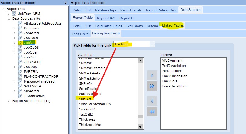

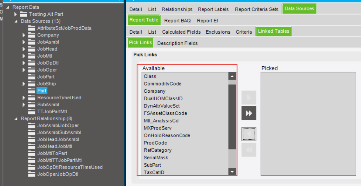

So… I guess my point is… IF you’re showing “default” Sub Parts… Then you should be able to simply add the SubPart column to the ALREADY LINKED PartNum table in the RDD:
Click on JobMtl table > Linked Tables > Description Fields > Choose PartNum in the dropdown > Move SubPart to the “Picked” columns.
Then in your RDL… all you should need to do is add T2.PartNum_SubPart to your query and as a query field.

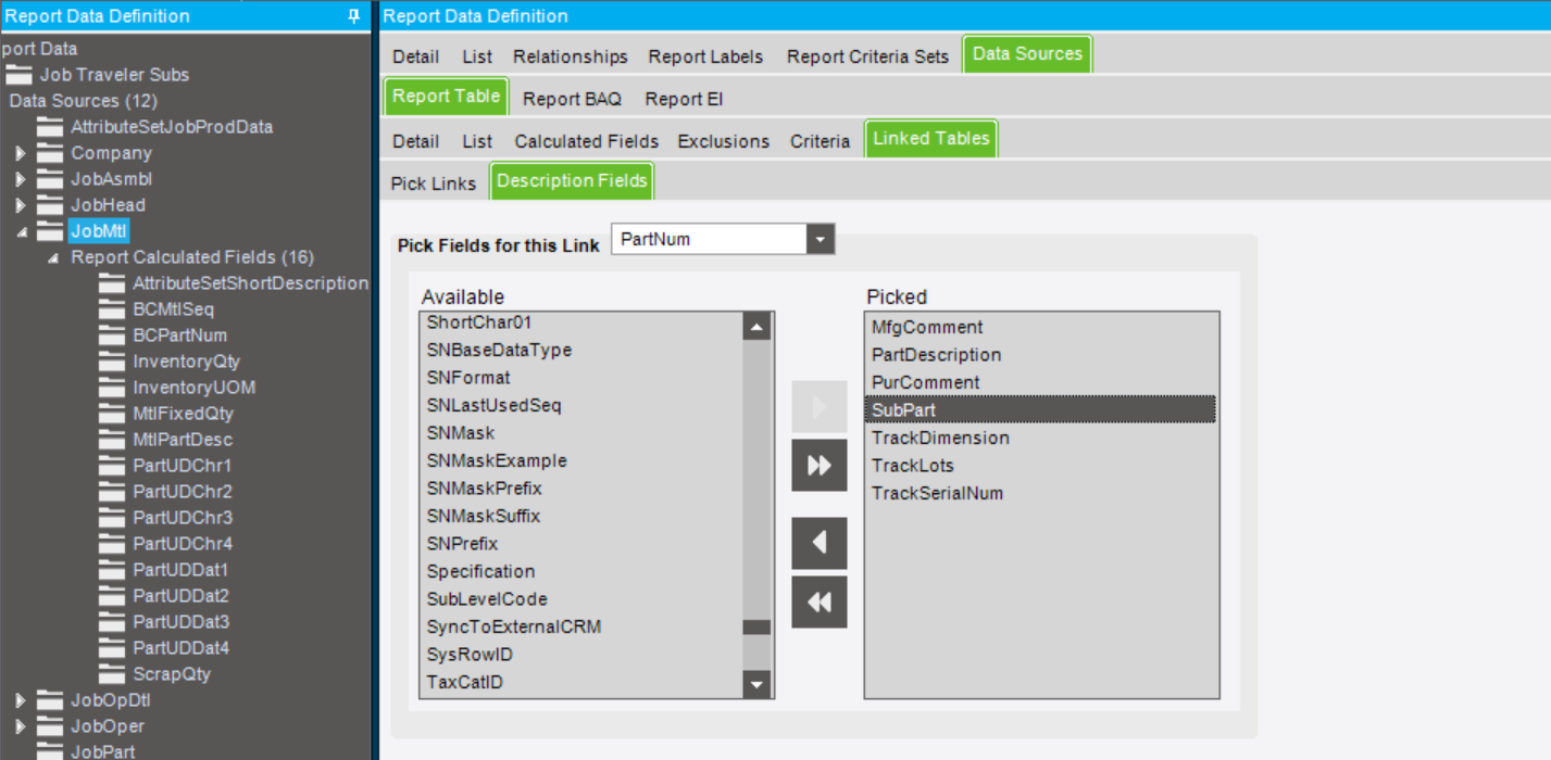

Ok - I started from the beginning again :slight_smile:

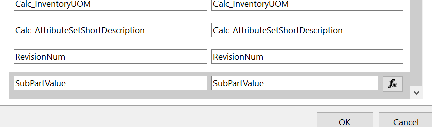

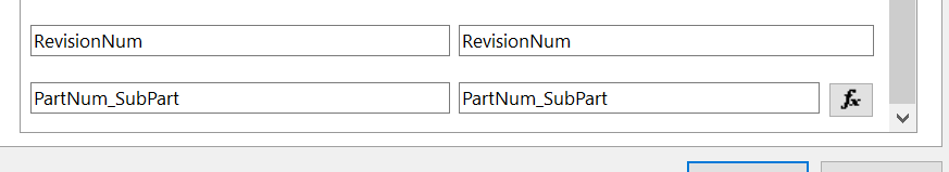

Added the SubPart
Added it to my report query:

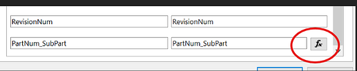

Added it as a field:
Added it to my report:

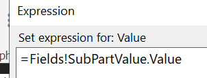

And it prints the words instead of the value

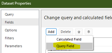

Don’t use an expression, just “add a query field” when you’re adding a field to your dataset.
Based on this… you’re adding a “Calculated” Field instead of a Query Field.
Make sure you pick Query Field when you add it.
Well they sure hide that option well … thank you so much - I’m not going to cry myself to sleep tonight :slight_smile:
