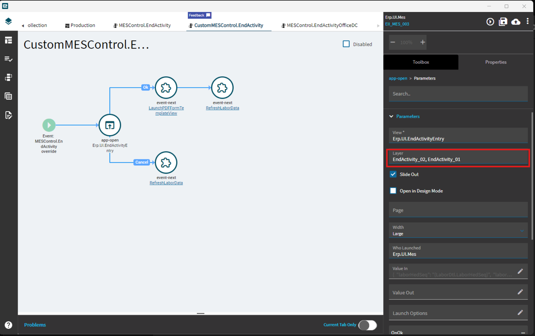

I’m attempting to add two layers to the End Activity screen using an override of the MESControl.EndActivity event. I am going into the App-Open widget in the event and trying to type in the names of both layers but it doesn’t seem to be working. I’ve attempted using a comma and a semicolon to separate them but am having no luck so far. In Menu Maintenance putting multiple layers on a screen is very simple, but when performing an override for MES is where I’m running into issues. Has anyone done this?
Well the solution was simple. Put a comma with no extra spaces between the two layers like the system does in Menu Maintenance. If you have spaces you won’t see either layer.
