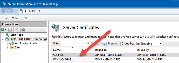

Update: I changed from the FQDN to a different name, and I assigned a SSL Cert to the the one that exists on the IIS certificate area for this machine.
The cert is valid and I am able to ping the server with zero issues.
In IIS, I located the Default Web Site.
I right clicked and selected Bindings…
From there, I selected the HTTPS binding and double clicked to edit.
In the Host Name field, I put a * and in the SSL drop down, I selected the SSL Cert issued by this machine.
After that, I was able to provison the new server.
