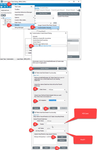

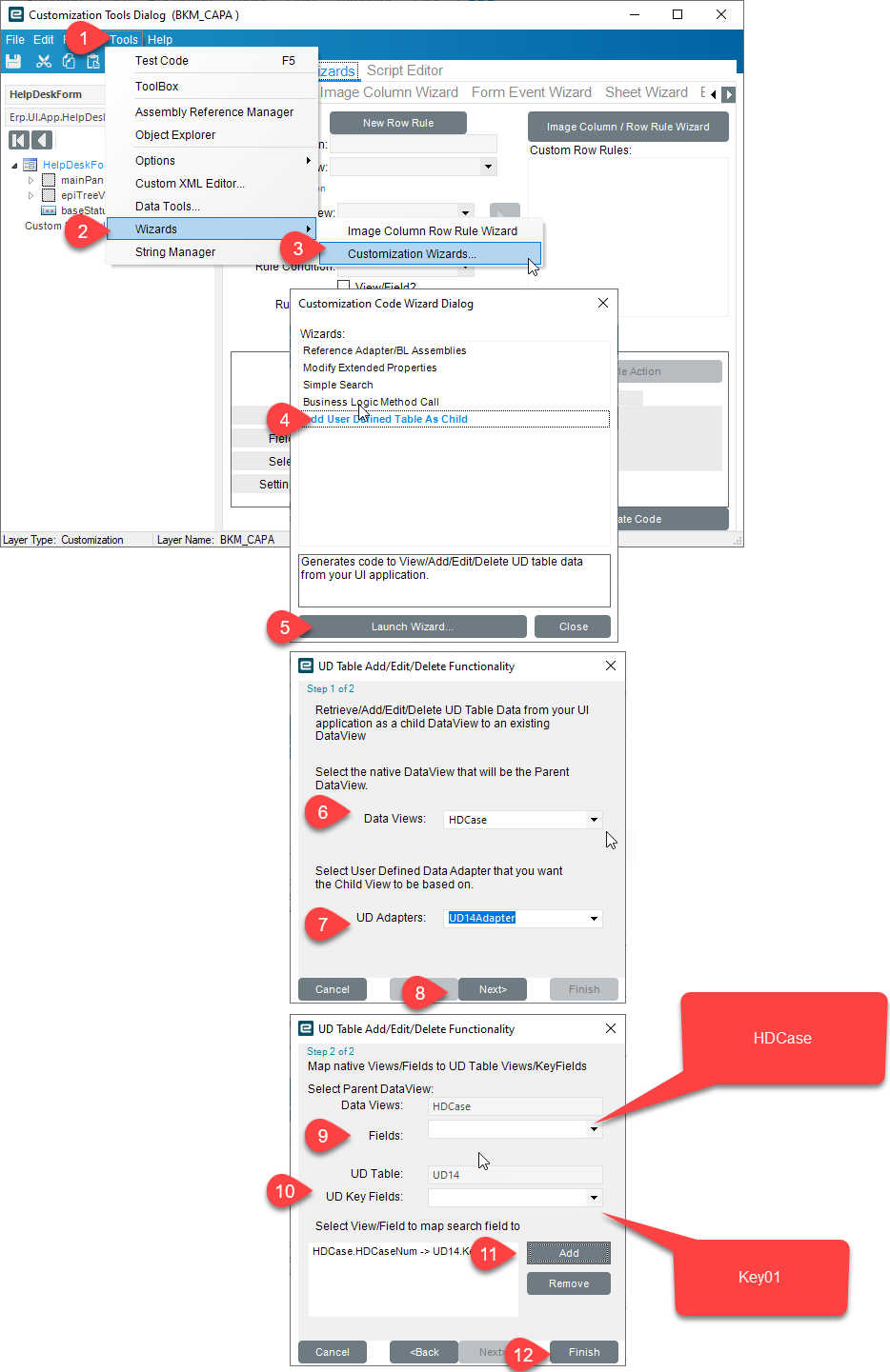

Adding New UD Row to Case Entry form
I’ve been reading though several threads about adding a new UD table. Not sure if this is accurate, but from what I can tell, not all forms are created equal when adding UD rows. I need help on what I’m doing wrong.
I’m trying a add a new UD row on the Case Entry form. My objective is to add a new CAPA (Corrective Action Preventative Action) per Case Number if required. I’ve already added the new Tabs per the Sheet Wizard.
After adding the sheets, I added a User defined Table as a Child. See steps below

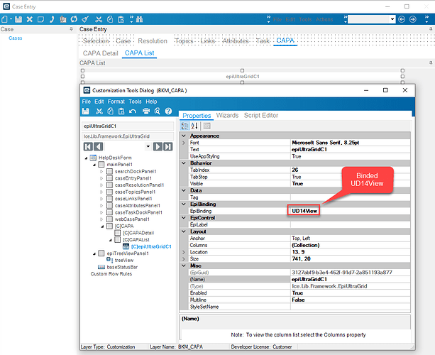

I then added en epiUltraGrid and Binded UD14View to the form.

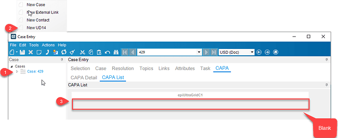

I save a restart the form. When I go to add a new UD row, I get nothing to return.
Is there a step I’m missing?
See code below
